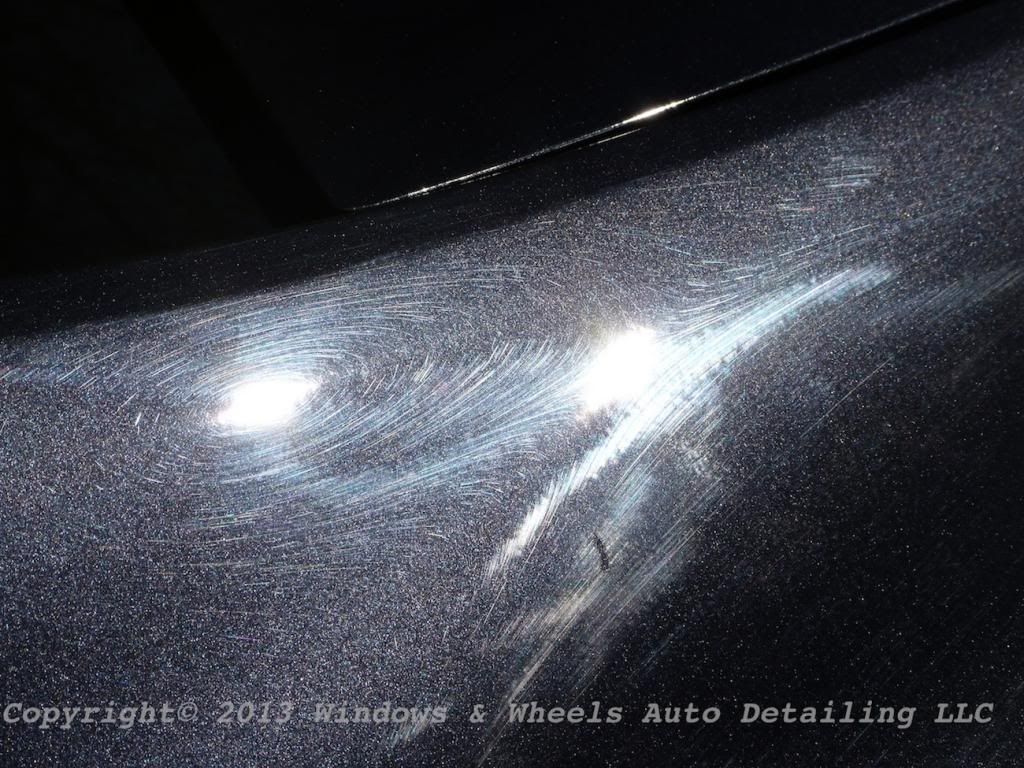

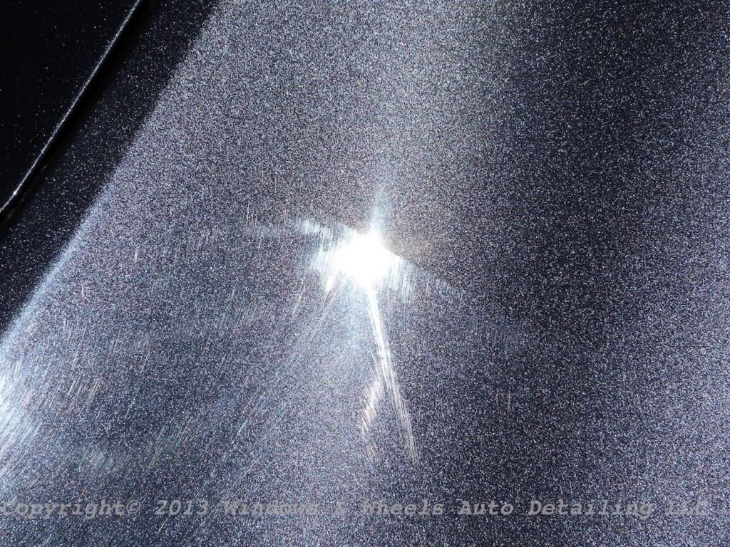

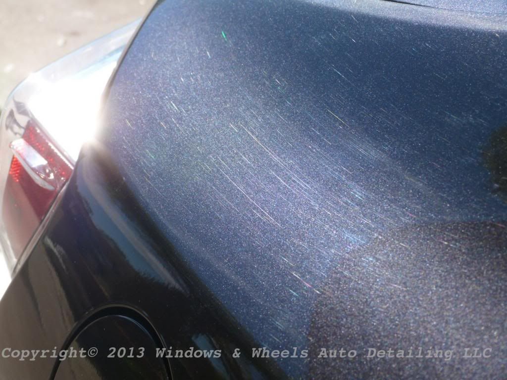

So I have had my car since June. Since then I bought an unlimited pass to a local hand car wash that has great reviews. I was washing my car almost 4 times a week because I couldn’t stand seeing dust on it (live in an apartment complex). Well after months and months of washing at this place only I started noticing more and more surface scratches. Swirls everywhere but tons of straight scratches. They may be a hand car wash but they still use crappy towels that are used on a million cars. The technique they use is horrible. It may be ok for cars that have hard clear coats.

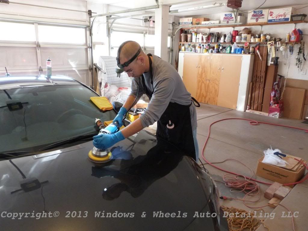

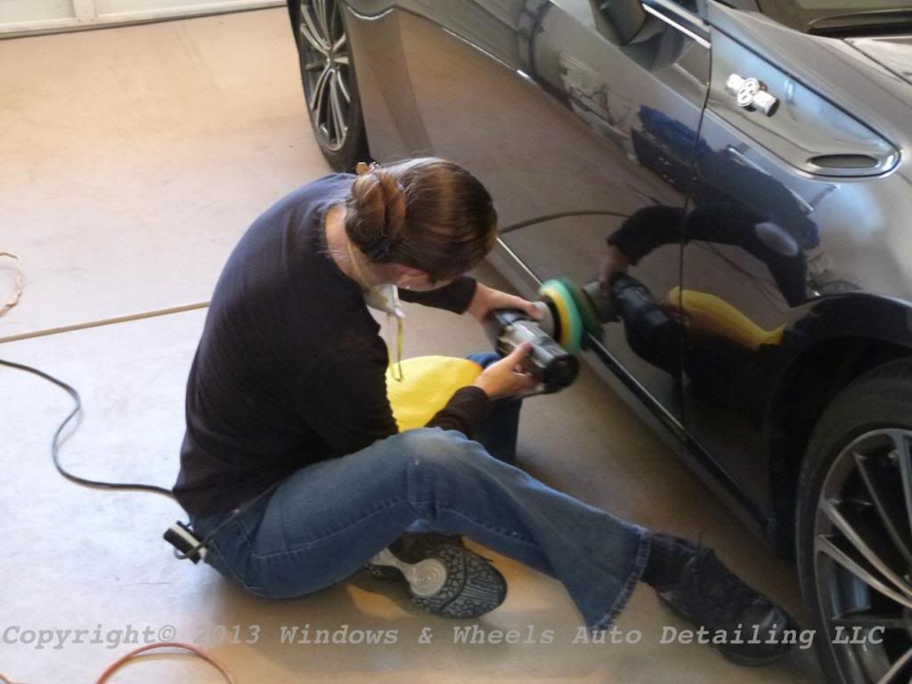

Here are the steps they took on my car
-Prep washes (removing old wax/glaze/dirt etc.)
-Decontaminated (clay bar) to remove bonded contaminants (tree sap, rail dust/iron deposits, bird droppings, industrial fall out etc.)
-Paint inspection
-Machine Compounding to remove heavy swirls,scratches,holograms and other defects
-Machine Fine Polishing to remove light hazing/marring from compounding step
-Paint sanitized to remove polishing oils and re-washed to prep for Opti-Coat Pro
-Opti-Coat Pro applied to paint, wheel faces and hard trim pieces
This includes the wheels, tailights and headlights!! The wheels have never been so easy to clean!!

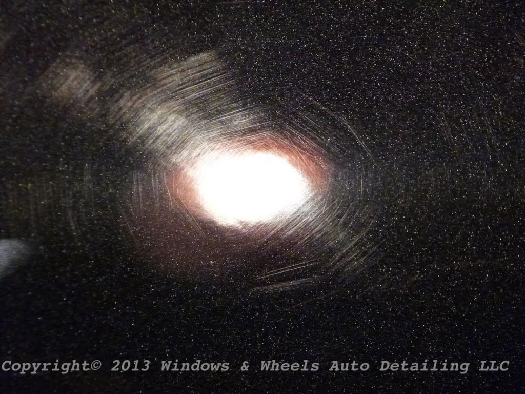

A few before shots showing the horrible swirls and scratches
Here are some during and 50/50 shots
