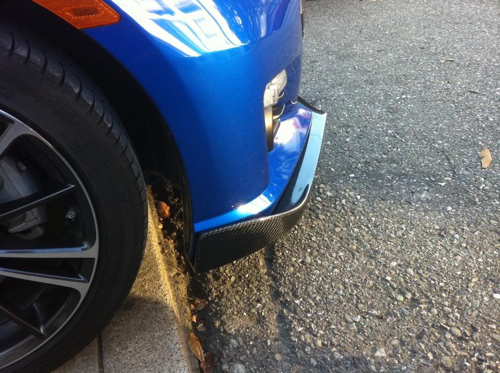

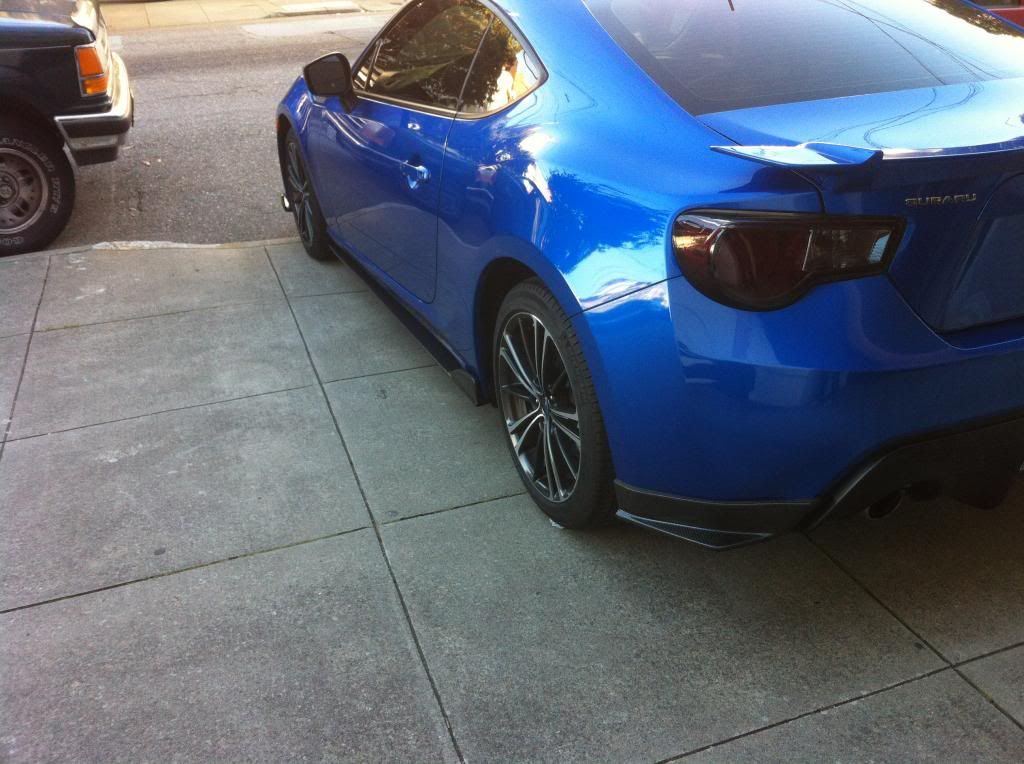

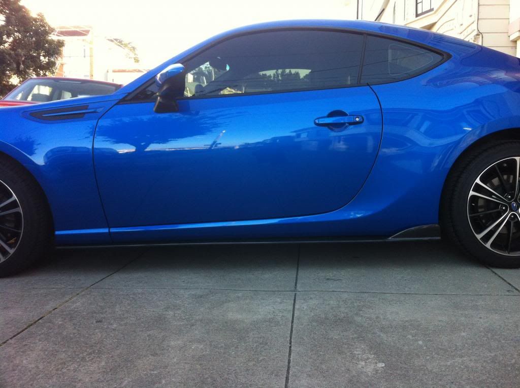

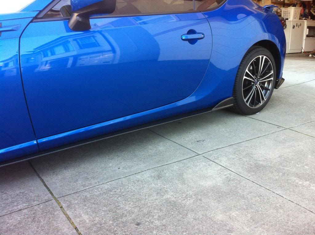

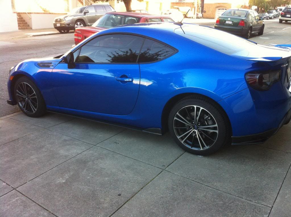

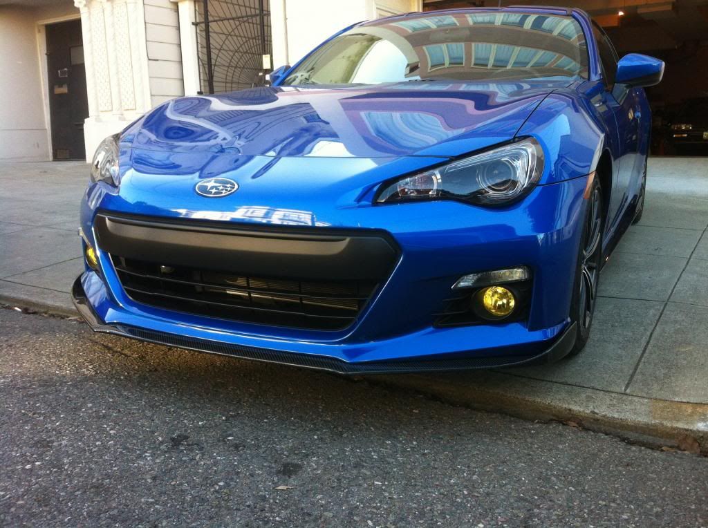

Here are some pics of the lip kit install:
stainless steel bolts, similar install to the HT Autos lip install with regards to removing underpanels. i did not remove the front bumper for this install.
used some weather stripping for the rear spats. I got them from my dad, he had them leftover from a kit he had for his vw scirroco maybe 23 years ago! so i dont know where to purchase something like this, it has a notched that fit the edge of the molding perfectly, and this flap that extended down, which was perfect for 3M tape to help secure

yeah ill post more pics hopefully later today. But yeah i think Seibon had "guidelines" but everyone else who have been isntalling lip kits just drilled them on directly. I preferred to use a nut bolt and washer method for the lip so thats why i decided to go with the method that the HT Auto lip was installed. This made more sense and is straight forward now, but to be honest everything took a while for me to do. Time was consumed in just not being familiar with the nuances of the car (darn plastic plugs) and also not having all the right sized hardware, which i couldnt really prepare for. I kind of had to go as it came.
The lip kit is pretty sturdy, i have about 13 SS bolts in the front lip, and for the side skirts it was 2 rows along the side (so theres less flex if there were just one row) and that was about 12 self tapping screws total (6 locations along the way). And for the rears, i utilized the existing plastic plugs and added 2 SS nuts and bolts, one underneath and the other on the side wheel well.
As for the rear spat weather stripping. I decided to go that route to not only decrease the amount of moisture that will get trapped in there (not like there would be much though, i know) i wanted to also protect my paint there. Since the spats came the edges seemed like they would just scratch it all up especially in the event i didnt secure it well enough or if i ever want to take them off in the future. I know up close it may not look nice to some, but i like them, and personally you cant tell when youre even just standing distance away.

IMO I dont like the kit coming up the sides in some spots. It looks too aftermarket. That chrome bolt on the side of the front lip kills it. The kit does not flow with the lines of the car! You can tell it was bolt on ! If you like it god bless. You sealed the deal for me APR is the only way to go if you want a carbon fiber kit.

I'll add some touch up paint or black silicone to the bolt. I agree that it stands out.
