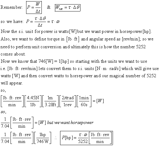

Where does 5252 come from?
If you have ever wondered where the number 5252 comes from in converting from torque to horsepower then here you go. Note, this write-up assumes that you have had a course in general physics.

I need to get me some education. Pretty cool post though.
