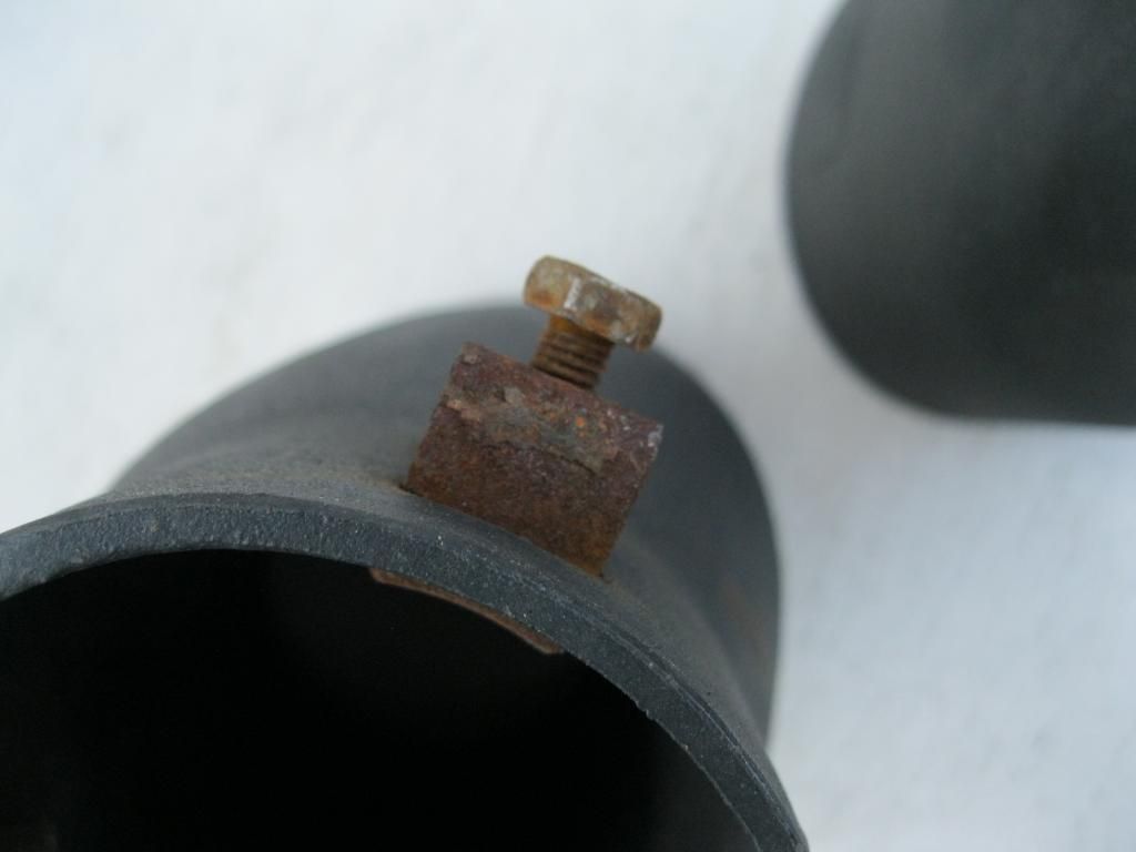

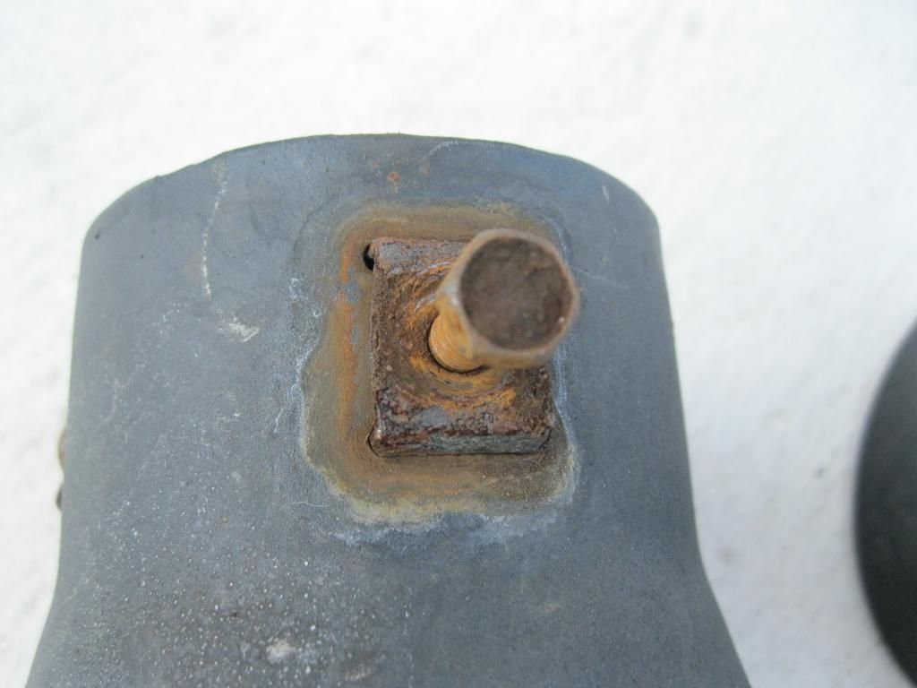

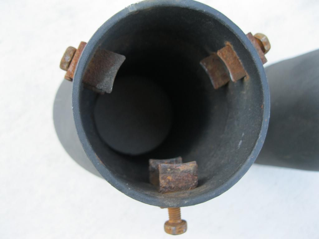

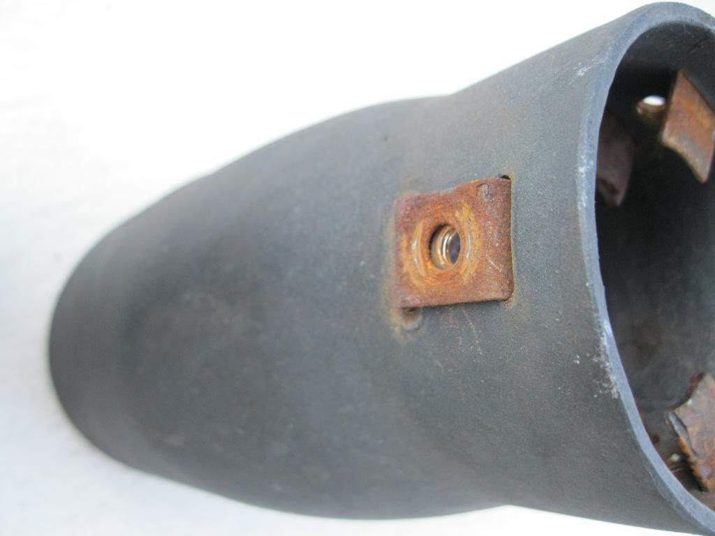

What happens when you put DC Sport tips on your car for three months...
I bought these DC Sport tips to replace the tiny OEM exhaust tips on the FRS.
About 2 weeks ago, i noticed heavy rusting on the screws and metal claps, along with discoloration on the tips even after trying to wash them.
Now before i post the picture of what it looks like, i will let you know that where i live in New York (Long Island) we only had one day of snow, even if the car was driven through snow often, the results of this rusting is just...stupid. I do wash the car often but i do it myself and i don't really wash the underbody.
Taking these tips off was a bitch...even with WD40.
Pictures:
When it was on the car....
I'm going to send am email to DC sport for the hell of it, i don't have the proof of purchase anymore. I traveled to two different pep boys to get these tips. 40 bucks wasted? Hell yeah...

Moral of the story--always get stainless steel fastening parts if you are in the north and/or there is salt involved. Galvanized if you can. The less something can rust, the better it will look.

Now that I think about it, you may be able to pick up replacement clips at the hardware store, and at least get something besides non-stainless. Brass may work as well.

Definitely no salt on the road here on Long Island, but given that it *is* an island, there's a good amount of ocean moisture in the atmosphere that will quickly create rust for non-stainless unprotected metals.
