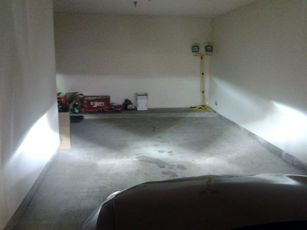

What's wrong with my HID kit?

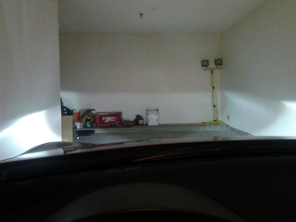

So I installed an HID kit yesterday and it seems like the the light is really scattered to the far ends. Looks like the driver's side beam heads way off to the left and the passenger side way off to the right, leaving an empty kind of V shape of not much light directly in front of me (where you'd want it). I put some pics below - You can see how the light in the center is kinda weak but the light off to each side is significantly brighter, also while the overall cutoff of light is at a decent height, it looks to me light the light beam is a little low too... I tried adjusting the height of the headlights (which had no issues with OEM bulbs) and it's not doing much.
Any suggestions on fixing this?

Tech support available from the seller? I know nothing about HID replacements, but it looks like the light beams are crossing each other which would lead me to think that either the bulbs are too short or too long since the placement of the bulb in respect to the reflector is what focuses (or aims) where the light goes. Sumpthin ain't right.

its like your bulbs are sideways or something

i think you bought the wrong bulbs or they gave you the wrong bulbs. there are types of HID bulbs that do go side ways. i usually see them on fogs

Is it h11 bulbs also make sure the are in all the way.

Yeah it looks like they're installed wrong. I vaguely recall someone else having a thread like this. Take them out and make sure the tabs are fitting into the appropriate slots in the headlight housing, and that you get a full turn in the housing.
