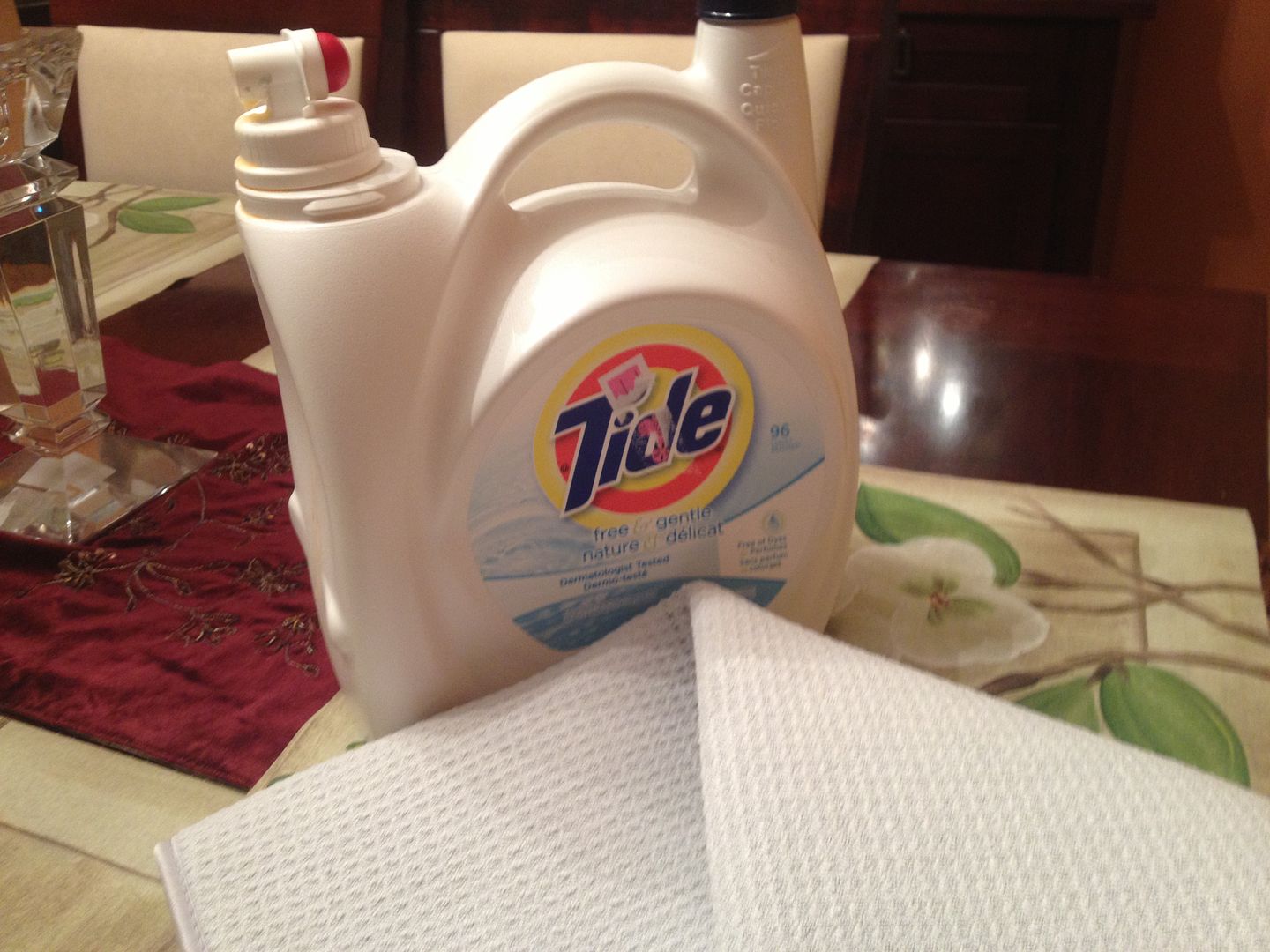

Step 1. The Break In, your towels will have to be machine washed before they are ready to use on your delicate paintwork. You wash them because you don't know who has been touching them before you and they may contain dirt and debris.
I used Tide Free (Unscented, Hypoallergenic detergent) but you can also use specialty brands MicroRestore and Chemical Guys MF Wash.
Once you let it air dry (Never put in a dryer) then it's ready for use on your vehicle.

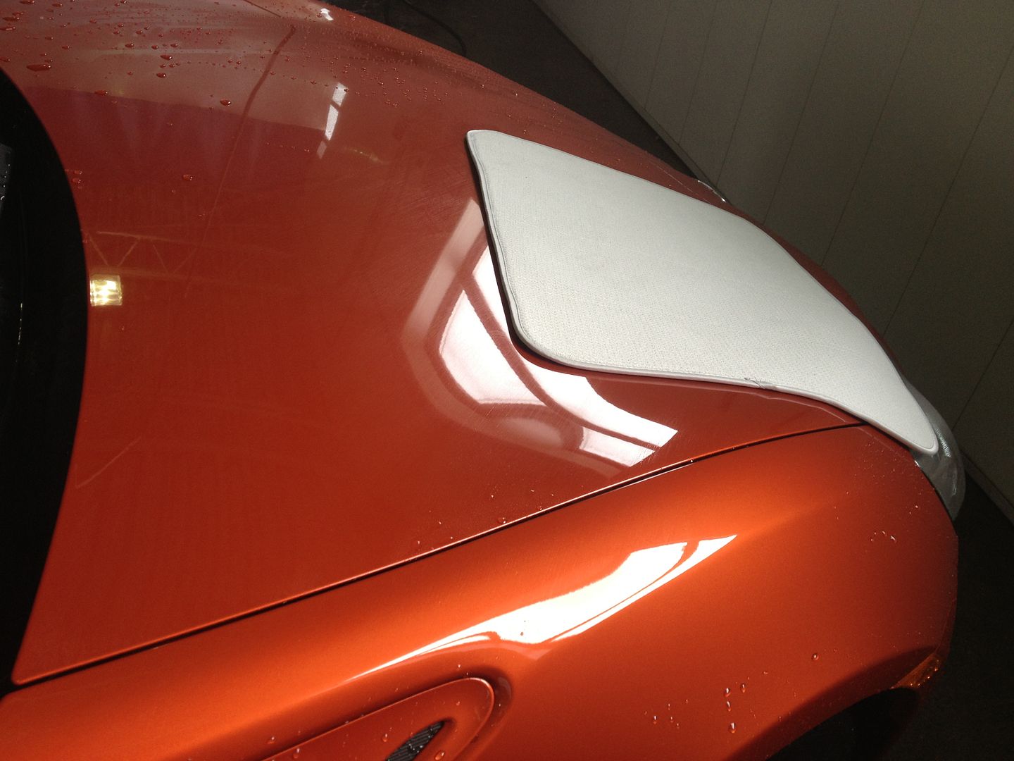

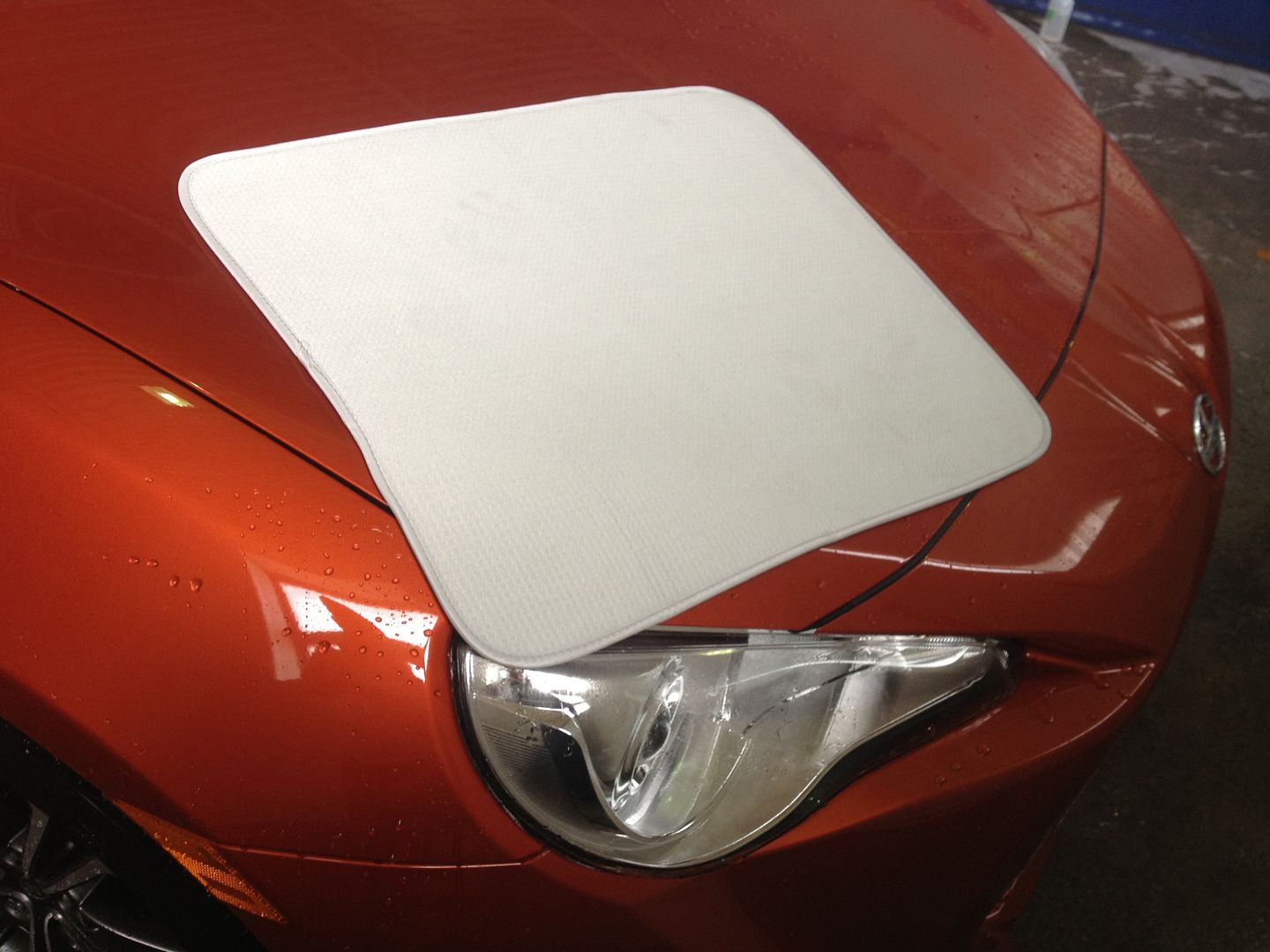

Step 2: After a thorough wash, your vehicle will be ready to dry. Use the first towel to pick up any of the major water deposits on your paint, use the second towel to pick up any isolated water that may be dripping from things like the trunk or side mirrors area. I recommend pat drying the vehicle instead of dragging the towels across the paint minimize swirling and it the method seems to work better with this towel. If you car is OptiCoated/Guarded then water will run of the vehicle better and there will be less work for you to do
