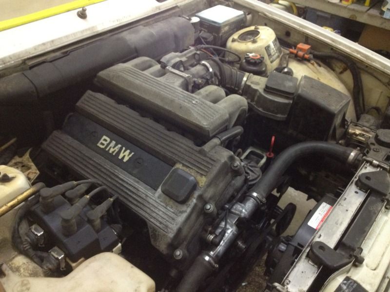

Some progress for my little project! I found a hairline crack in the oil pan, causing all the oil to slowwwwly leak out. Luckily I discovered it as the car sat for a couple weeks at my friend's shop, and not through driving it until it ran dry. I replaced the oil pan, gasket, upper and lower timing cover gaskets, front main seal, thermostat and water pump, and cleaned a ton of sludge off the engine. I also ditched the clutched mechanical fan for an electric unit.
Where'd all that come from?
Engine bay with fan removed:
Sludge, sludge everywhere:
Timing cover removed:
Several hours, cans of brake clean and a toothbrush later:
Accessories re-installed:
Electric fan installed:
All buttoned up:

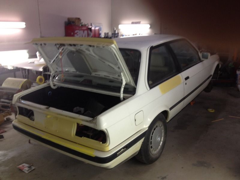

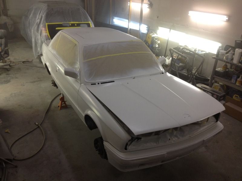

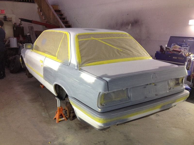

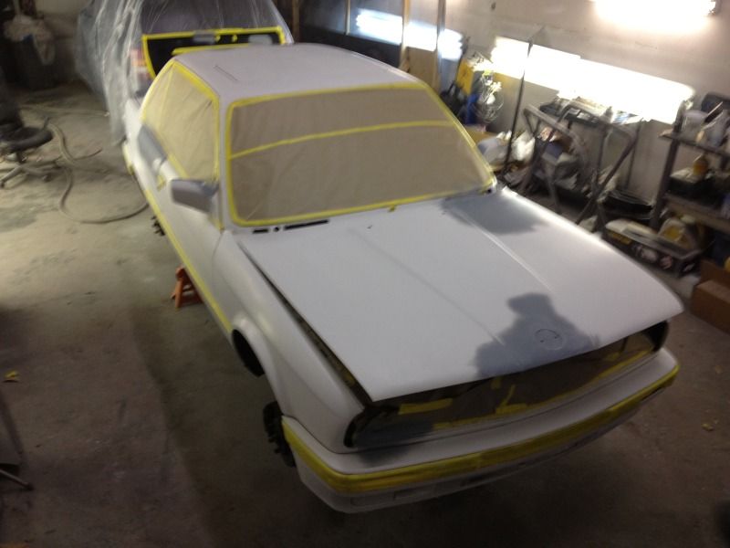

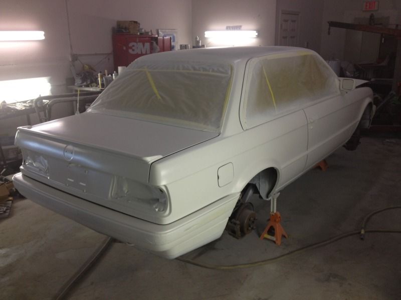

While handling the mechanicals, the car was being prepped for paint. My friend Derek took care of the major dents, sanded down the rust on the trunk and other minor surface rust areas, and primed the repaired areas. He also took the cracks out of the OEM spoiler and got it all smooth and ready to spray. He just finished up buffing it yesterday, so I should be picking it up this week!
Alpine White II paint (OEM color):
Base coat laid down:
And the clear coat:
