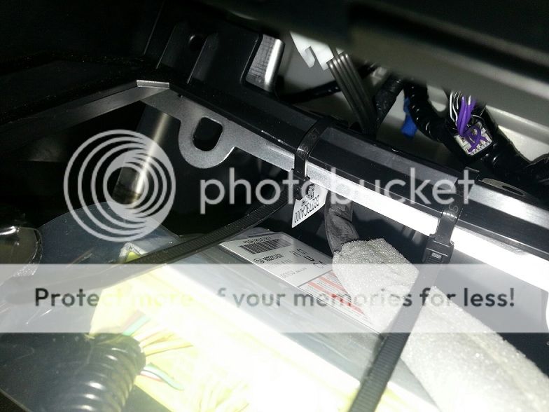

My AC controls rattled as well. I was able to diminish it substantially (but not entirely). If you remove the trim piece the holds the USB port, you can reach in there and feel a plastic piece that touches the dash. I threw a couple zip ties on that to hold it snug.
Also, with that same USB trim piece removed, if you look where the center console attaches via screws, remove the two screws and you'll see two metal brackets. The left one was rattling like no other. I slid a couple pieces of electrical tape underneath the bracket so it fits more snugly against the plastic.
(Picture swiped from Trojan_SC)
You can see the metal piece on referring to in this picture:
OMG you just made my week...the zip ties trick seems to have worked to make my rattle go away!!!! At least for now! *fingers crossed*
Just an update that this rattle started to come back a bit even though I had the zip ties installed. BUT, I had the HVAC out for a mod, and I cut the zip ties hoping to be able to locate the rattle with everything open. The rattle didn't occur, so I started putting things back piece by piece and checking for the rattle after each part. The rattle didn't come back, and hasn't come back in a couple weeks (even though there are NO zip ties or anything now)! So the cause of this rattle may have something to do with the HVAC connectors being loose or something. I'd advise taking out the HVAC and then putting it back in making sure all of the connectors are secure. Worked for me (for now at least)!!
