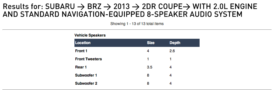

What are the Stock speaker rated at ? RMS ?
Hey Guys
I have been searching around trying to find out what the stock speakers are rated at ? RMS watts
For each of these speakers below ?
http://www.ft86club.com/forums/attac...1&d=1338904942

2013 Scion FR-S:
Front Tweeter x 2 (On dash)
90 mm (3.5 in.)
4 Ω, 21 W
Front Speaker x 2 (On dash)
25 mm (1.0 in.)
4 Ω, 21 W
Front Woofer x 2 (In door)
160 mm (6.3 in.)
2 Ω, 33 W
Rear Speaker x 2
90 mm (3.5 in.)
4 Ω, 21 W
Jeff

Does anyone have the numbers for the BRZ head unit and/or amp?

Interesting the front 6.5's are 2ohm that definitely throws my plans off. I was told by a guy doing a high quality build on a BRZ that the front speakers while being 2ohm can be upgraded to a 4ohm driver as long as they are fairly efficient. The factory one he said was only 84db.
