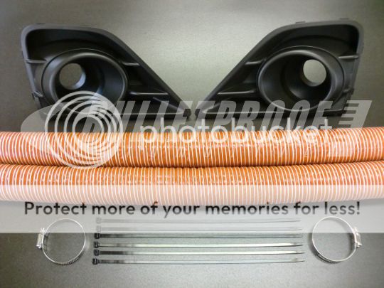

I think cooling ducts is a grossly underrated option. I will try the pad, SS lines, race fluid, and cooling duct/hose route first. It might be enough to hold back heat soak.
Wish a vendor produced a kit like for the BRZ.
Edit: Just found this.
http://www.ft86club.com/forums/showthread.php?t=11041
RYU is offline   Reply With Quote
I know there is one for the FR-S but Im not satisfied with it. It just comes out of the fender instead of hooking up behind the brakes.
I will say that I took the FR-S out this weekend to a road course race with the second longest straight in the U.S and got up to 115 before braking into a long sweeping corner at around 60. hese brakes stock are VERY GOOD without any modifications so I am going to venture to guess that just by upgrading the pads, fluid, lines, and adding PROPER ducting would be more than sufficient for a turbo setup.
I ran 10 times over the course of two days on a 1.8 mile track so I would say that I got a proper feel for the braking capability. Time in between track time was about 30 minutes to an hour.
I was in a novice group and was doing this for the first time. This car is EASY to learn. Novice drivers in Porches ( A lot of them as this was a Porche Club of America event) were having to let me by, by the time I went around the third time I was pushing the car to its limits while they were still learning the track.
Memphis is offline   Reply With Quote
