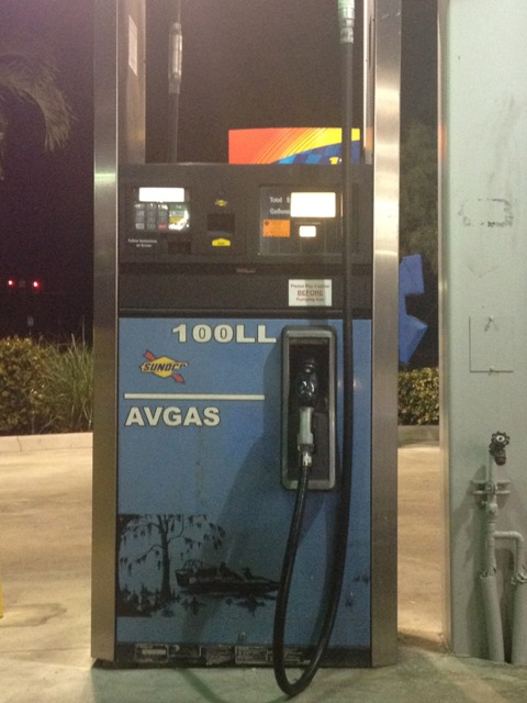

Old 09-10-2012, 11:42 PM   #7
F3dzo
F3dzo's Avatar
Drives: 13 fr-s whiteout
Location: South florida
Posts: 505
Thanks: 400
Thanked 211 Times in 107 Posts
I'll be back!!

Old 09-11-2012, 07:18 AM   #8
Sportsguy83
I Love custom Turbo kits
Sportsguy83's Avatar
Drives: Limited BRZ
Location: Miami
Posts: 10,770
Thanks: 20,004
Mentioned: 441 Post(s)
Tagged: 12 Thread(s)
Originally Posted by F3dzo View Post
where's this?
