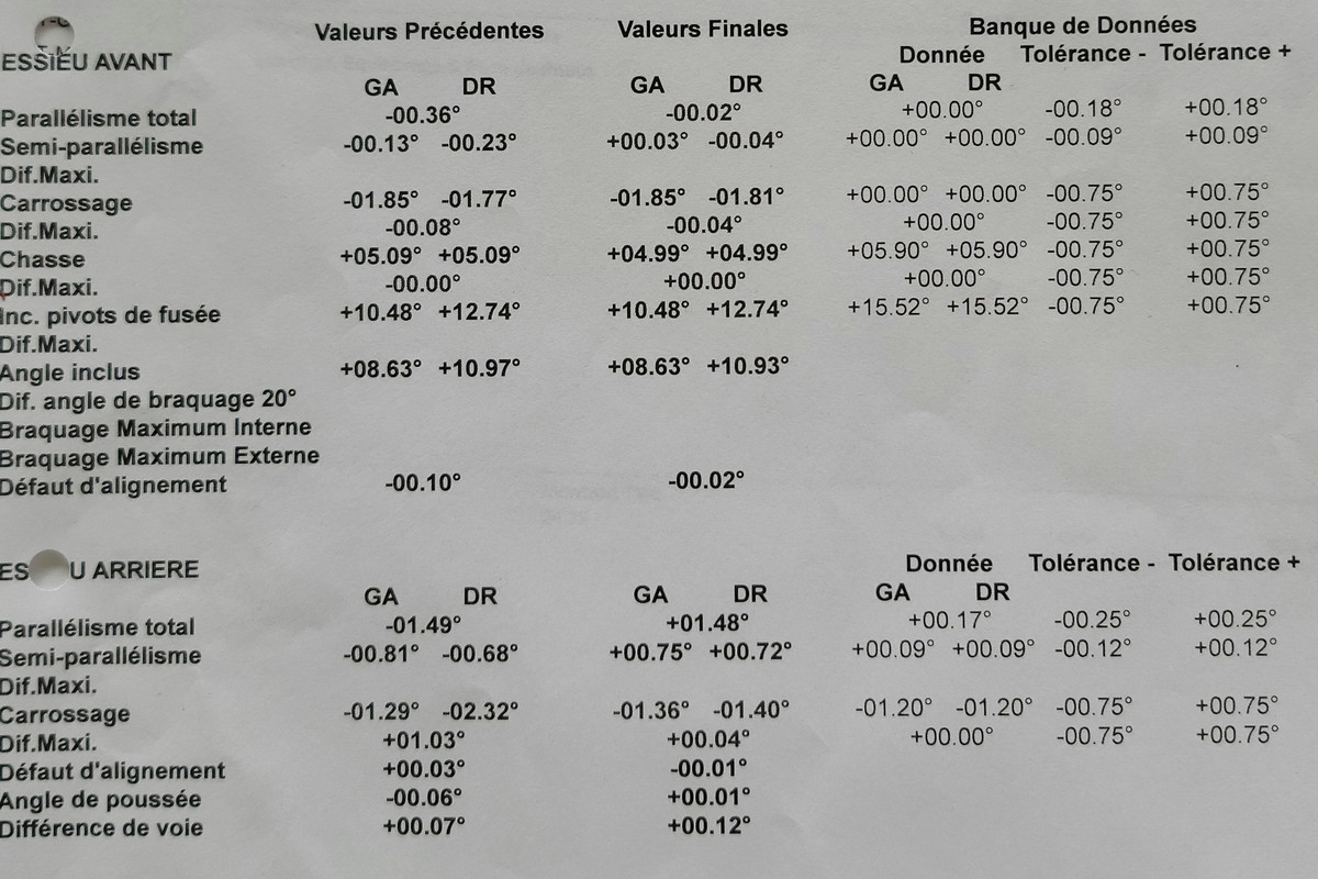

Posts: 38
Thanks: 7
Thanked 24 Times in 10 Posts
Sure, here's the printout. It's in French though. Top is front and bottom is rear.

Oh I think I know where the problem is... I asked for 1.5mm toe in in the rear, and they put 1.50 degrees... With 17' wheels, 1.50° is 11.3mm (7/16') !!! It has to be that, correct me if I'm wrong.

Many thanks for your help guys. I don't think there has been any slippage as I only drove 50km on the highway since the alignment and I didn't hit anything.
But what's sure is that with 7/16' instead of 1/16' toe in at the rear, the car isn't going to behave properly and the symptoms I'm having make sense under that light... I will call the garage who made the alignment and ask them to correct that under warranty.
