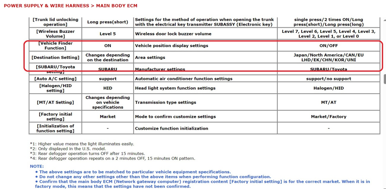

Yes, I knew it....it the Main Body ECM customizable settings is where you select the destination (market) for the car, this changes the cluster to display mph or kph and miles or kilometers based on the region. There is no programming necessary...
This is all the original dealer should've changed. I'd bet they shorted something in the unit attempting to reprogram it that is causing the issue.

Is that image from the BRZ service manual? I will definitely bring up the main body ECM customizable settings when I go back to the Toyota dealer with the US ECM. Thank you for that.
Edit: I'm looking in Techstream for the 2015 FR-S and can't find documentation about main body ECU customizable settings, unfortunately. This might be something that only Subaru's dealer software can do.
