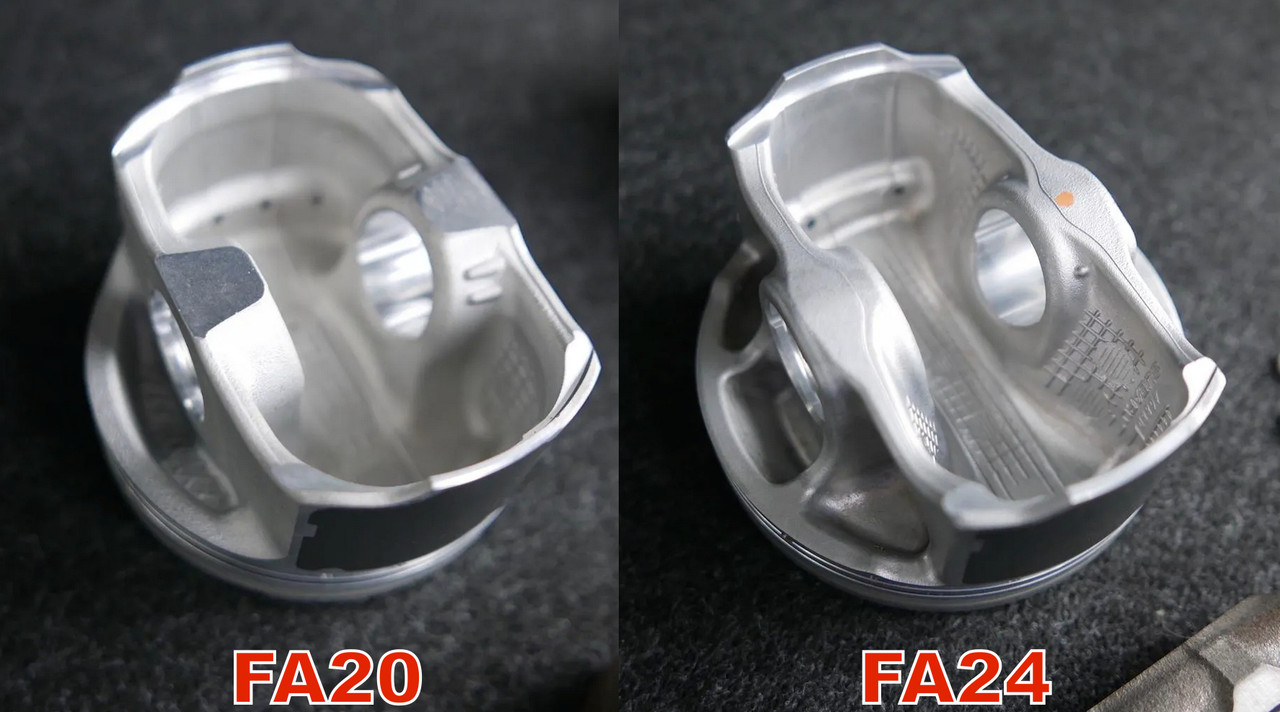

FA24 FB25 pistons
The FA24 due to the extra displacement will make 350whp with less boost, and it is starting with significantly beefier Pistons and rods, so the reliability factor in theory should be much higher.
Do you know if the FA20 and FA24 pistons use the same pin diameter and pin height? That FA24 piston looks a lot like a FB25 piston. I wonder if its the same? Both 94mm...
I'm interested in fitting new sleeves to an FA20 to run the 94mm pistons

Possible candidate
I think this is an FB25D piston. It's the only picture I've been able to find.
I have no idea. Check the part numbers
