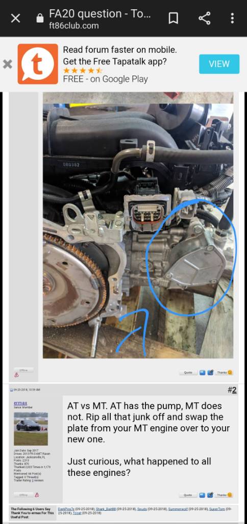

I'm guessing it's this spot right here, secondary vacuum pump behind the 3rd cylinderName:  Screenshot_20220513-134745_Chrome.jpg

Originally Posted by DJjoey0812 View Post
I'm guessing it's this spot right here, secondary vacuum pump behind the 3rd cylinderAttachment 211895
Sent from my SM-G998U using Tapatalk
Yep
