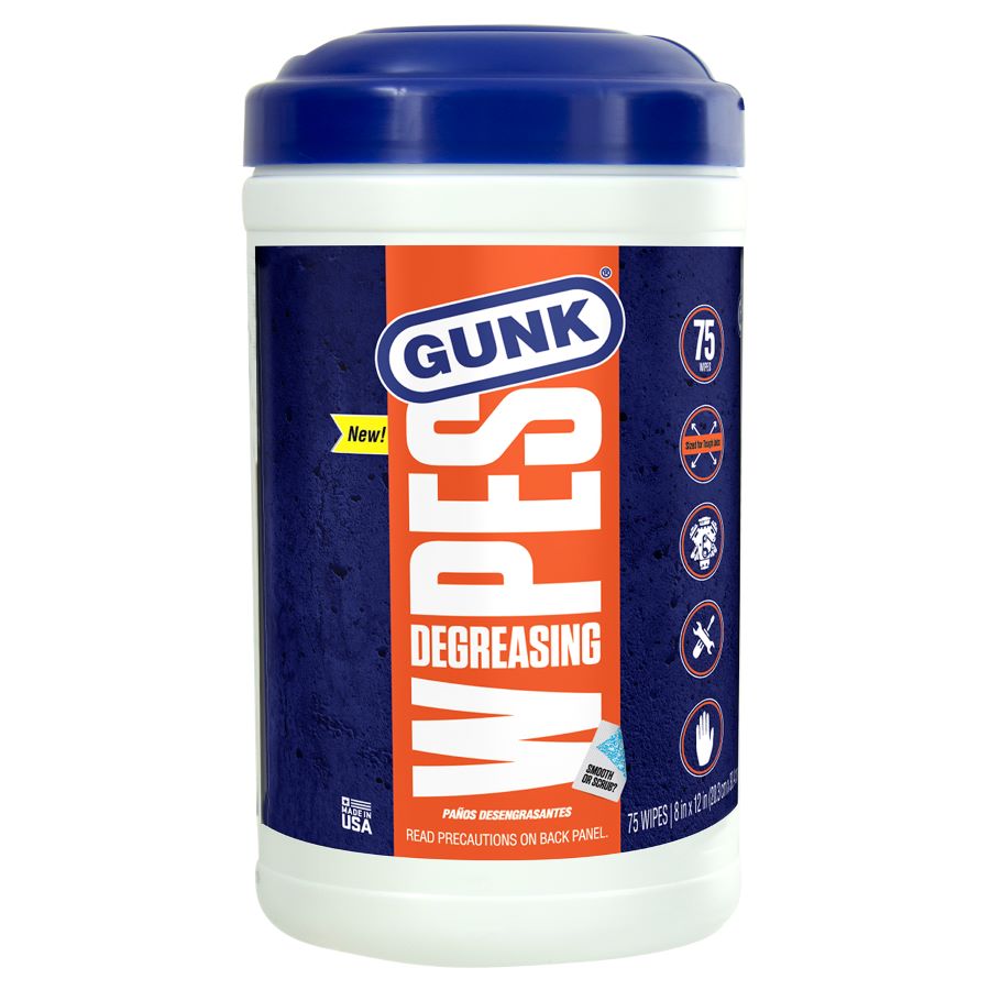

Gunk Wipes are amazing. Follow up with a soft brush.
