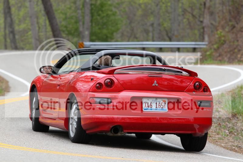

back when i built these tail lights(ABS rear assembly, polycarbonate lens, needed to cut the hole in the lens, and fill the gap between the 2), a body guy recommended evercoat fibertech for the big filling part, and then finish coat it with evercoat polyflex.
it did work, but after about 3 years of natural thermal cycling, i could see a slight gap in the paint.
