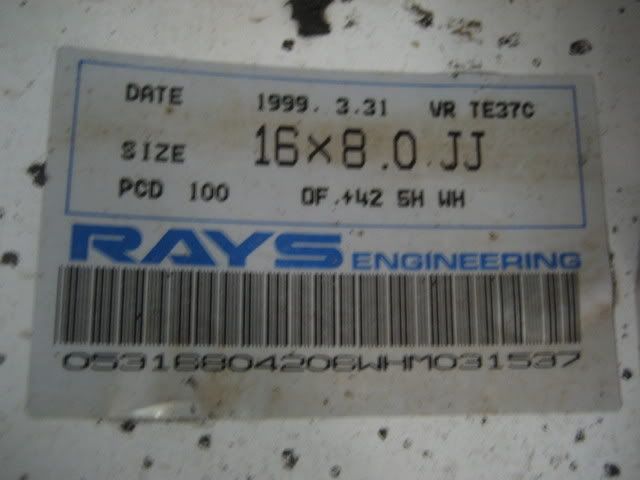

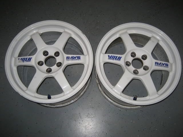

Anyone have 16" wheels on their FR-S/BRZ? Not sure if TE37s come in a 16x8 5x100, but that would be a great light set up. The (my) end goal is to shave off as much rotating mass as possible. Also, 16" race tires are cheaper.
Edit: Whoa!!! Apparently they do exist!

that'd be cool with some FAT tires and a drop. Go for it.
edit: make sure they clear the brakes and whatnot.

245/45-16 sized tires are pretty much an exact match for the stock diameter.
With the wheels in the picture, you would be 9mm closer to the suspension, and 21mm further out towards the fenders.
