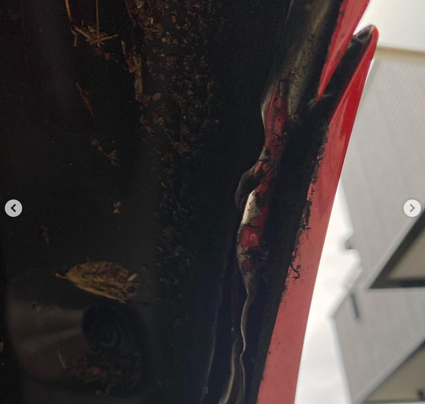

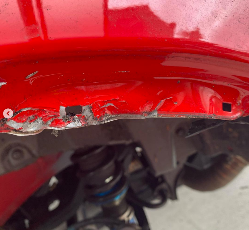

This one from Japan shows the damage to the rear
Owner: www.instagram.com/708_zc6/
Unknown wheel and tire specs
from this guy's instagram, he said he was on 265/35r18 on 9.5 in wheels with +45 offset and 15mm spacers, but he didnt say if the spacers were front/rear or both.
Yeah, I saw that post before, but it wasn't clear what the issue was. Language barrier, all that stuff.
The rear looks pretty low to my taste, so I thought the owner just didn't set up the bump travel correctly (see video below), and the tires were hitting metal first before the bump stops were fully squished.
Well, it might still be a valid explanation, or at least a partial solution?
If only there was one language used everywhere and Japanese folks shared their findings on this forum, that'd be great for everyone...
