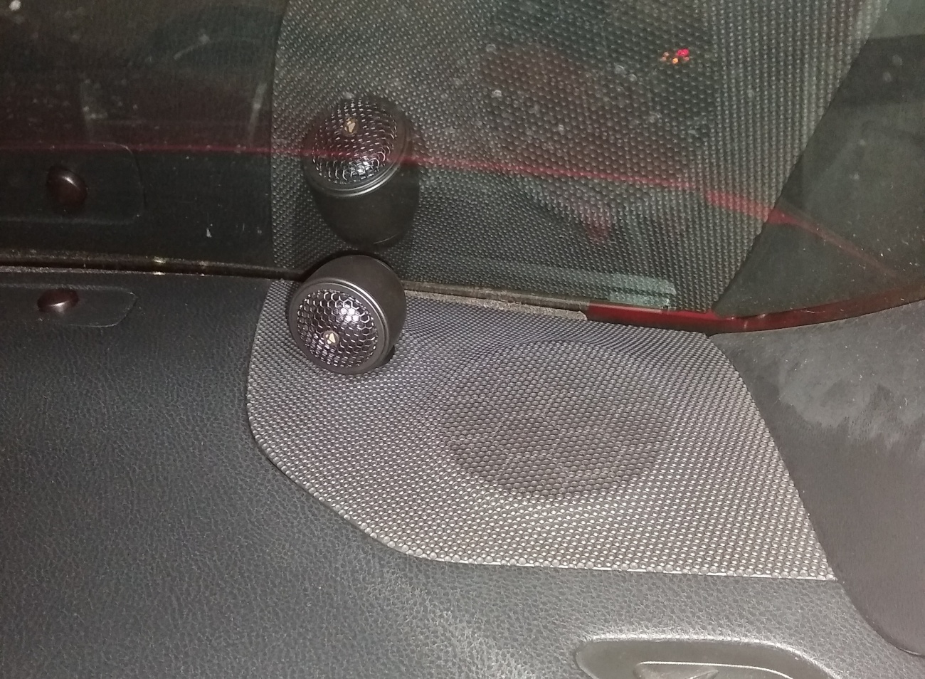

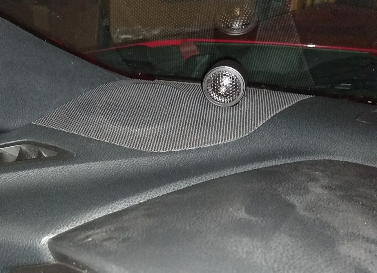

For highs, just yesterday I installed some Kicker pod-mount 3/4" tweeters mounting them to the dash speaker grills and have them bandpassed between 5kHz to 16kHz at 24db/octave on both ends. See here,

For mid-range, I have some Dayton Audio 3-1/2" drivers in the factory dash locations which are bandpassed between 2kHz and 5kHz at 24db/octave on both ends.
