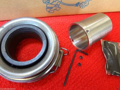

Being that my FRS is now in need of a throw out bearing, I came across this kit where the seller claims the fork is a direct swap which is stronger than the stock 86 unit.
https://www.ebay.ca/itm/192694423638
https://sixstarbernie.com/i-23188134...1998-2018.html

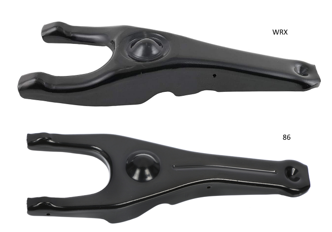

I'd be interested to know if anyone on the board here has experience with this as it could be a good in-between option from stock before the $215 Versus one. Price I see the WRX 30531AA180 Clutch Fork for is only $18 which is nice.

From what I can see of the two forks online they're largely similar... not 100% if they're the same length and angle though

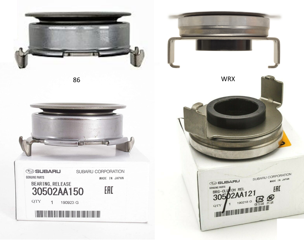

The WRX fork seems to be missing the holes for the bearing clips and uses a different bearing 30502AA121/30502AA120 with no clips however, the kit I linked says their bearing is a replacement for the outdated 30502AA051 and visibly has clips on it.

Thanks for the responses, I messaged the seller and they said it's 100% compatible if you grab a non-STi 2013 WRX Bearing & clips to use with the WRX fork.

I don't have a high degree of confidence that swapping the fork and the 2013 WRX bearing is essentially identical.
