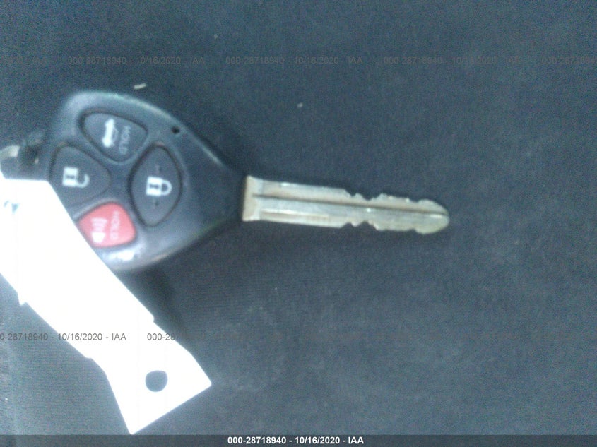

I also had a picture of the key
There is plenty of youtube videos on cutting a key off a image. I tried twice, unsuccessfully.
So instead, I remove the door lock cylinder, I was able to, sorta impression a key with that. Meaning I put the key in it, examined it, filed, repeat, until it was right. I was now able to unlock the steering wheel and get it off the trailer.
