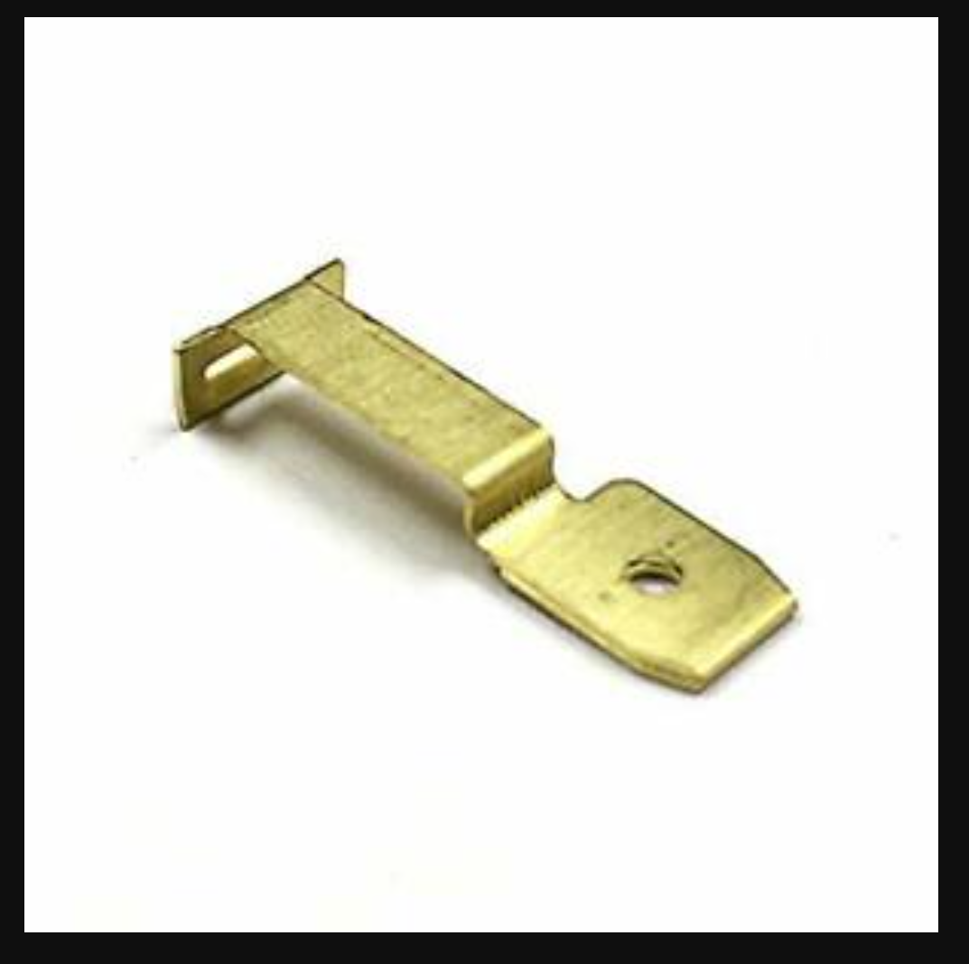

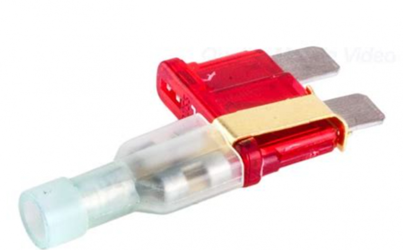

Try one of these at the fuse block inside the passenger compartment.
