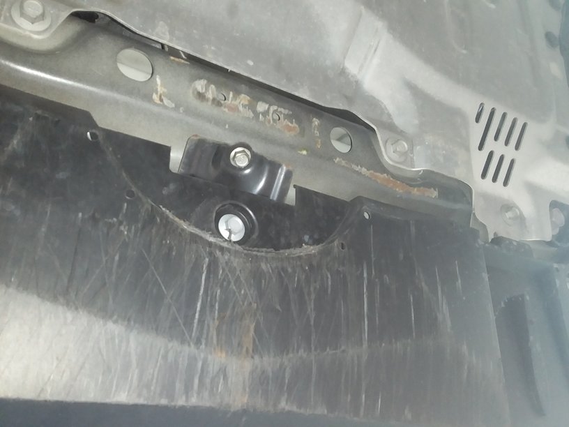

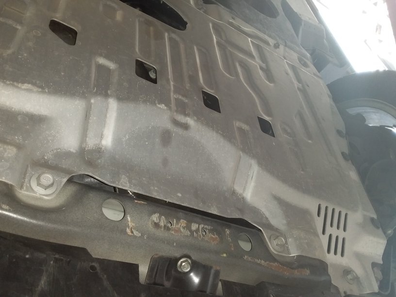

I drove up on some ramps today and took some snaps of the undercarriage. It seems I was being somewhat of a hypochondriac...Anyway here are the snaps (looks fine to me apart from all the driveway scraping - )

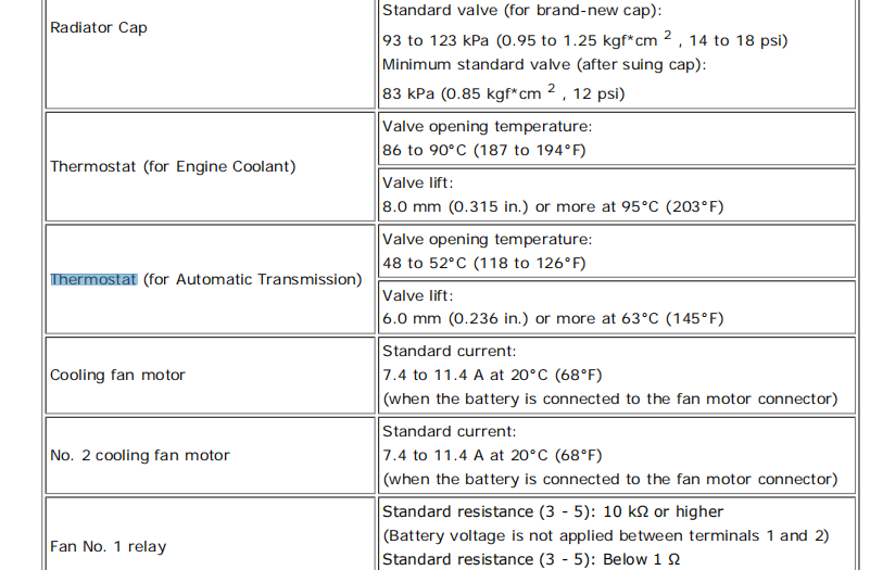

So I've had a read in the service manual. I think I might have found my issue. It is in fact the temperature sensor...
Name:  Screenshot from 2020-02-18 21-48-39.png
The bottom warm up test fits my description perfectly..

Pictures: no damage
Yeah nothing to see here.
