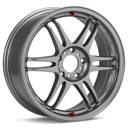

My set came off a mid Aught's Audi TT...the original red stems are almost faded back to metal.
Kosei wheels are lightweight!
IDK about old school, those were available on tirerack when I bought my twin. And, they also were, IIRC, $200 each. So, IMO, they are not worth fixing unless you HAVE to have them.
I would just stick with what you have or get 4 different wheels. I can't suggest buying damaged wheels in this case.
