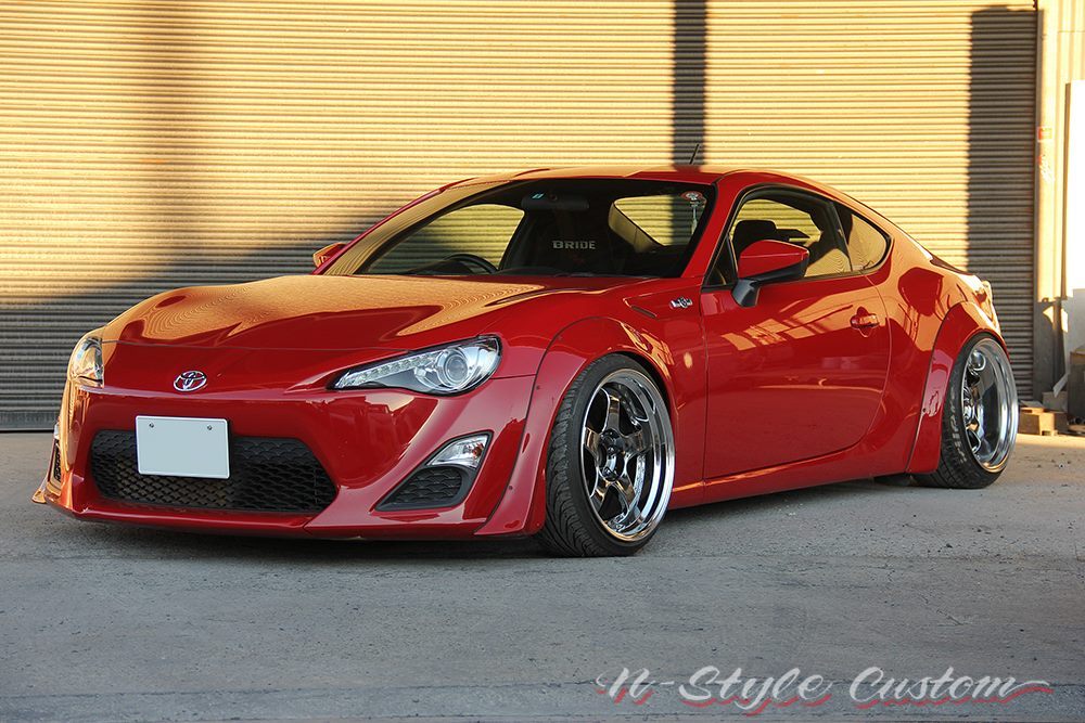

Check out N-style Customs on Facebook,,, they do lots of steel flares. The biggest issue as mentioned earlier is the bumpers and how those are dealt with. I figured if I did steel flares I's end up having to make extensions in fiberglass to extend over the bumpers. Ends up being lots of work with all of the body work, fiberglass work and you now have to paint/blend fenders.
BTW the red car above has N-Style fiberglass flares on it. They are nice but around $850 shipped if I remember correctly.
