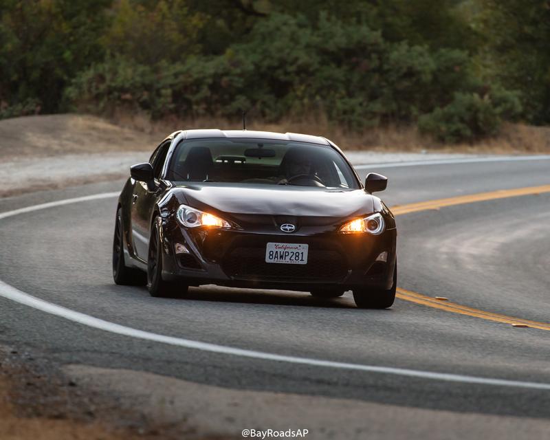

This is my raven black 2013 FR-S.
I purchased it in February of 2018 after five years of driving and racing Miatas. I see the FR-S as a spiritual sibling to the Miata(lightweight, agile, low-power momentum car), but with a more substantial feel and a rigid roof.

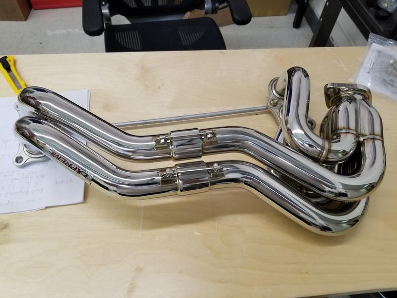

Tomei UEL Header

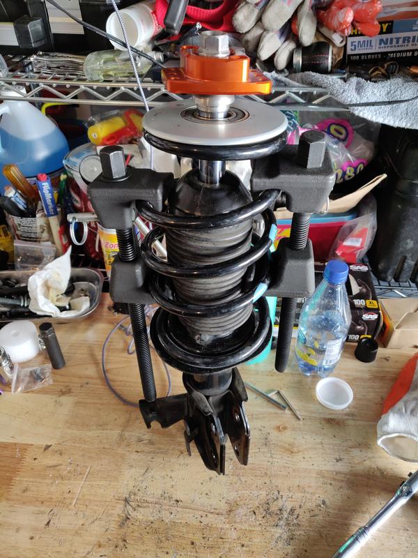

RaceSeng Camber plates with stock shocks/springs

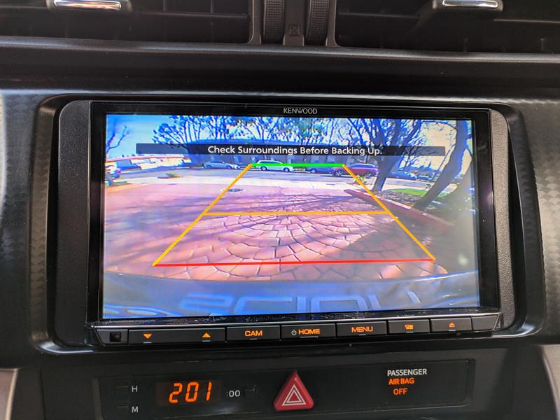

Feb 2019 - Head Unit and Backup camera install

Suspension:
2017 BRZ Performance Package Sachs dampers
2017 BRZ front springs (176lb/in)
2013 FR-S rear springs (211lb/in)
Perrin 22mm front sway bar
Megan front endlinks
Whiteline 16mm rear sway bar
Phase2Motortrend rear endlinks
Phase2Motortrend rear toe links
SPL Parts rear toe eccentric lockout
Cusco Wide Tread front lower control arms
Cusco rear lower control arms with braces
RaceSeng Caster/Camber plates
Whiteline rear subframe inserts
Alignment: Camber -3*f/-2*r. Zero front toe, 1/16" rear toe in, 6.5* caster

Kenwood DDX9705S double-din head unit
Kenwood CMOS 230 backup camera
iDatalink Maestro RR with OBDII integration
Engine:
Tomei ExPreme unequal length header
Subaru WRX/Forester oil heat exchanger
OFT ECU calibration by Tor
Thermal R&D 81825 18"x8" 2.5" single exit oval muffler
