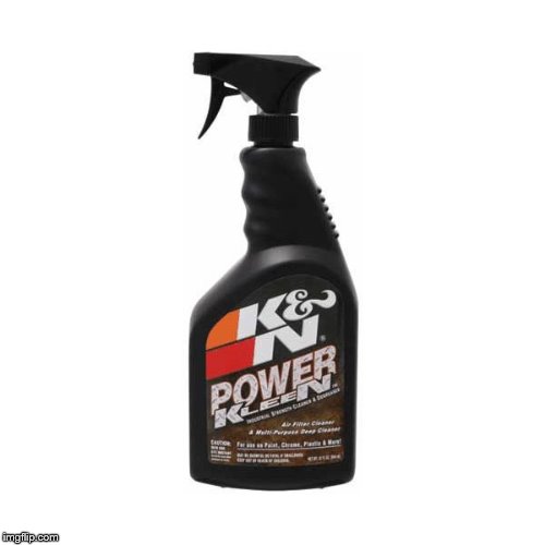

I'll keep that in mind. I actually forgot to mention I already have the K&N filter installed as well, which leads me to ask, do clean yours? And if yes how often? I'm new to the whole car stuff ahaha.

Depending on your environment and miles driven it could need cleaned more often than I clean mine. I check mine out every time I clean my engine bay, and clean it when it looks dirty. I used to live in the country, and had mice building nests everywhere in my car, including in my intake. Luckily they never ate my stock filter. They did eat a 3" hole in my trucks air filter though.
Don't use compressed air, it can degrade the filter. My best friend used to work at a motorcycle shop and gave me a bottle of this that I use. (follow the directions on the bottle)
