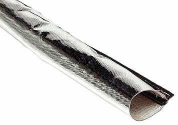

Having a hard time understanding what you mean exactly, or how that would get it further away from the engine block. Need a photo or something to see what you mean. Also, if I try routing it like how you are describing, it'll push the bend of the nylon line further forward and then it'll be near/in contact with my oil cooler lines which I don't want either.
I might just get something like this and put it around the lines for peace of mind:

Even the auto ignite point of gasoline is around 500 degrees. I think e85 is about 100 degrees cooler. So nothing to worry about, just wrap it in something so that it doesn't chafe the line, you can put some heat tape on it if it makes you feel more comfortable.
I run my kit bare, and I have a turbocharger under my hood.
You don't need to worry provided the lines are routed per the instructions provided!

I would have to aggree with CGS. As long as the lines are not chafing you are good. Those lines are roubust even though they do not look it. My clean and secure OCD kicks in. Too many years of aircraft where nothing is left loose or touching where it can chafe ever!
