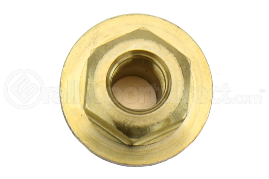

From this picture, and from what I believe to be the case, there are three unused oil galley plugs on the block: Part# 11024
The one on the top, driver's side, front of the motor is accessible. It is between the throttle body and ac compressor:
The rear oil galley plug, on the driver's side, on the back of the motor, is not accessible. It is behind the flywheel seen here:
The plug at the bottom, front, passenger side of the motor doesn't look to be accessible, as the timing cover seems to cover it:
You can remove the oil pressure, dummy-light sensor or T into it, and there might be other locations to T into throughout the engine, but not anymore galley plugs:
1. A galley plug with a hole is needed and the appropriate NP or NPT threads for that hole or a NP to NPT adapter can be used.
PT/BSPT
https://www.rallysportdirect.com/par...il-galley-plug
NPT
https://www.rallysportdirect.com/par...hreaded-center
Adapter
https://www.walmart.com/ip/Unique-Ba...=sem#read-more
2. BSPT or NP thread.
3. No port.
4. Usually NPT threaded holes on these sandwich plates.
5. I don't think this will work...only for use as an oil return hose for turbos or recirculating catch cans.
6. See attached photos...none is the answer.
