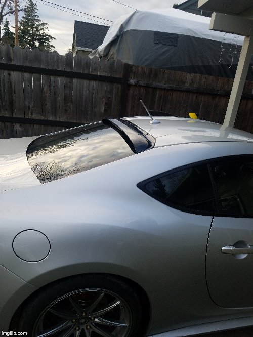

Some will appreciate this mod, some will not. I understand that it is not for everyone. But, I like building things; so here is what I came up with.
Take one of these. An Acura MDX moon roof shade 1100mm wide. Set it on the car. Tape off the half inch lip on each corner at the angle of the rear window. Now grind that 5-6 inch section off. I used a belt sander, it took about 10 minutes.

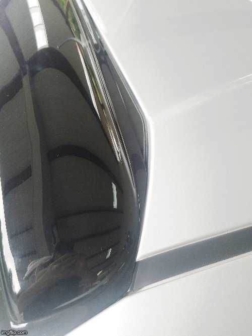

After grinding the corners the shade fit to the top in the middle and to the newly ground edge on the corner.
via Imgflip Meme Generator
Crooked image, sorry.
