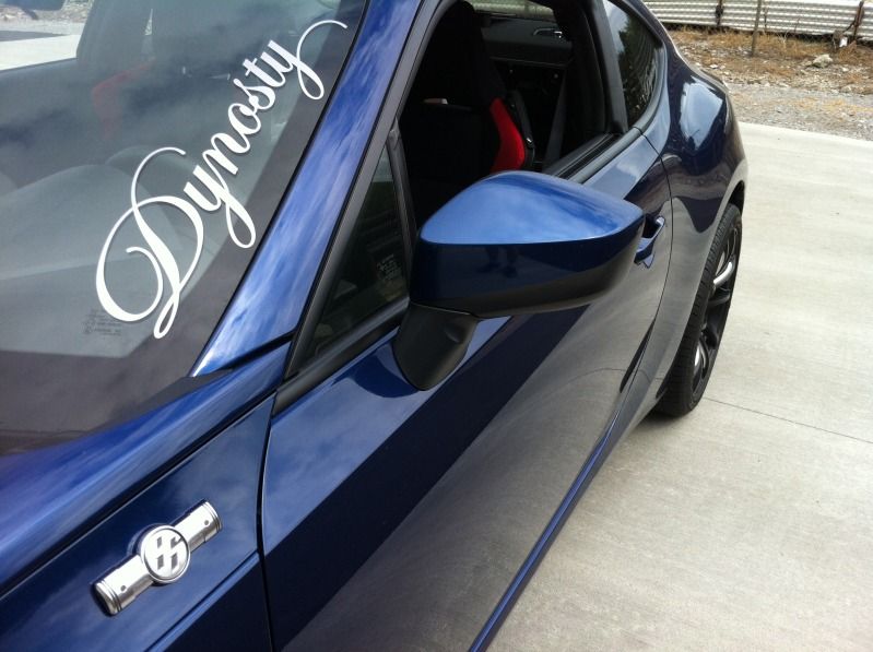

I would probably go +35 in front, +40 in the rear but thats definitely not the max you could go. This is 18x9 +40 on the rear.
