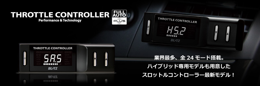

Throttle Controllers
I haven't seen anyone talking about these things yet, but Tom's, Blitz, and a bunch of other JDM tuning brands are selling electronic throttle controllers for the 86/BRZ. I was wondering if anyone has experience with these and can explain their use/value? I understand how they work, just curious if they are worth while. All my previous cars had mechanical throttles so these are new to me.
Examples:
Blitz Full Auto Light
http://www.blitz.co.jp/products/elec...ler_light.html
Blitz Full Auto Plus
http://www.blitz.co.jp/products/elec...ocon_plus.html

I can't find the thread but someone actually did a test or relayed a JDM test that showed that the throttle controllers work worse than stock and generally just make the car idle worse.

All throttle controllers do is trick the relationship between the throttle pedal (your foot) and the throttle blade (your engine). You can achieve exactly the same result by pushing the pedal down further or less. Its not magic, in fact its not even good. Its a gimmick.

It allows you to tune the throttle-by-wire's response time. I have something similar in my Audi, called "Drive Select". In normal mode there is a slight lag in throttle response (very slight) to improve fuel economy. In "Dynamic" mode it sharpens the throttle response to make it feel more sporty. In "Comfort" mode it delays throttle response even further, to avoid jerky accelaration. I almost never take it out of normal mode but there is a marked difference between the three modes. Would I spend the money on one of these, though? No.

These actually have some good applications - throttle response (in terms of adjusting delay) is just one small part. The value in these is to create custom throttle curves...
As an example, the stock Tundra has a crazy sensitive throttle - it seemed like the first 10% of throttle movement went from 0% to 90% of throttle, and the remaining pedal movement did little or nothing. This was a real issue when trailering and trying to back up, maneuver a load, be precise etc.
with this box, you can really have the first bit of pedal movement feathered out, and make it really easy to control speed on the low end. you could make a full linear curve, an economy curve.. or all on if you wanted
Granted, i'm not sure what application this would have on our cars.. I think the throttle is pretty well sorted.
