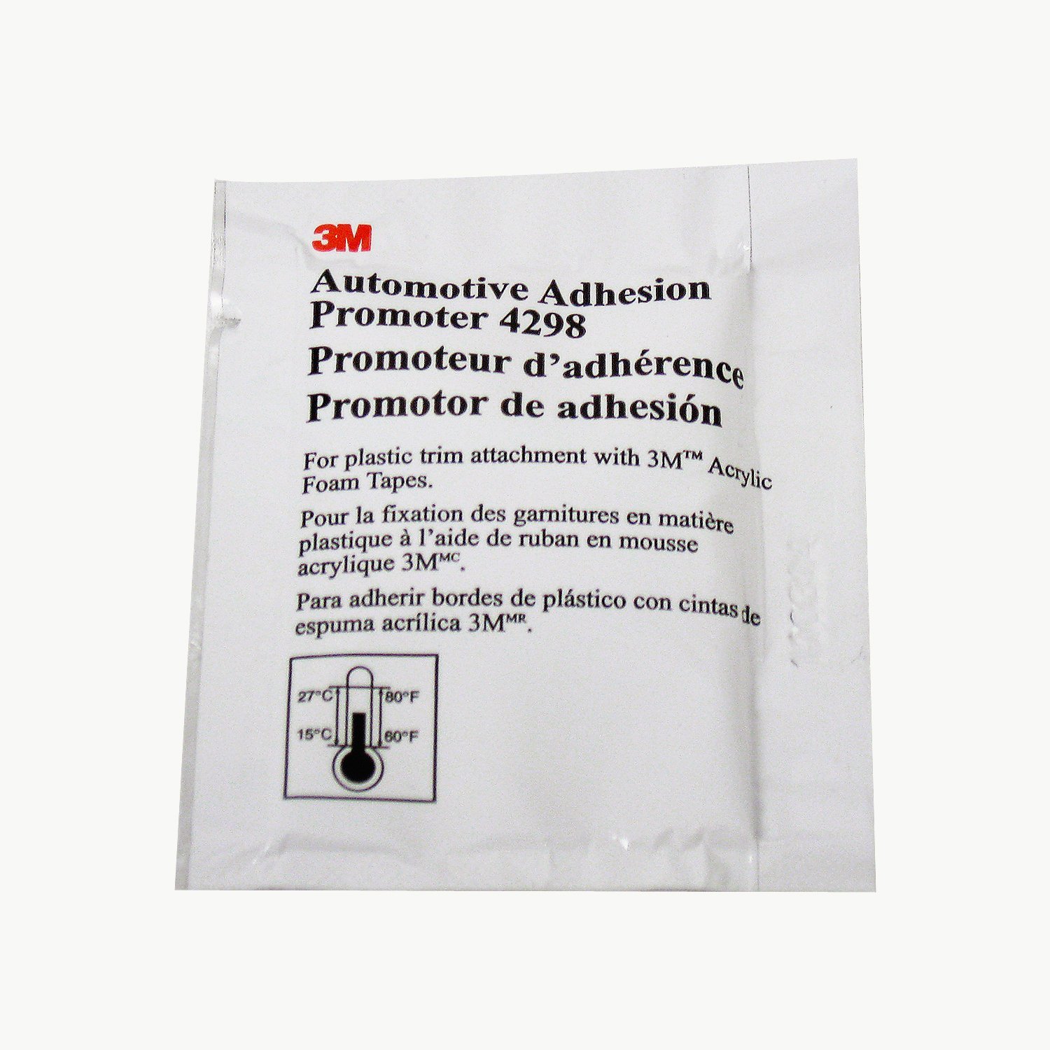

on a serious note make sure you clean the area well with isopropyl alcohol and use some 3M adhesion promoter
