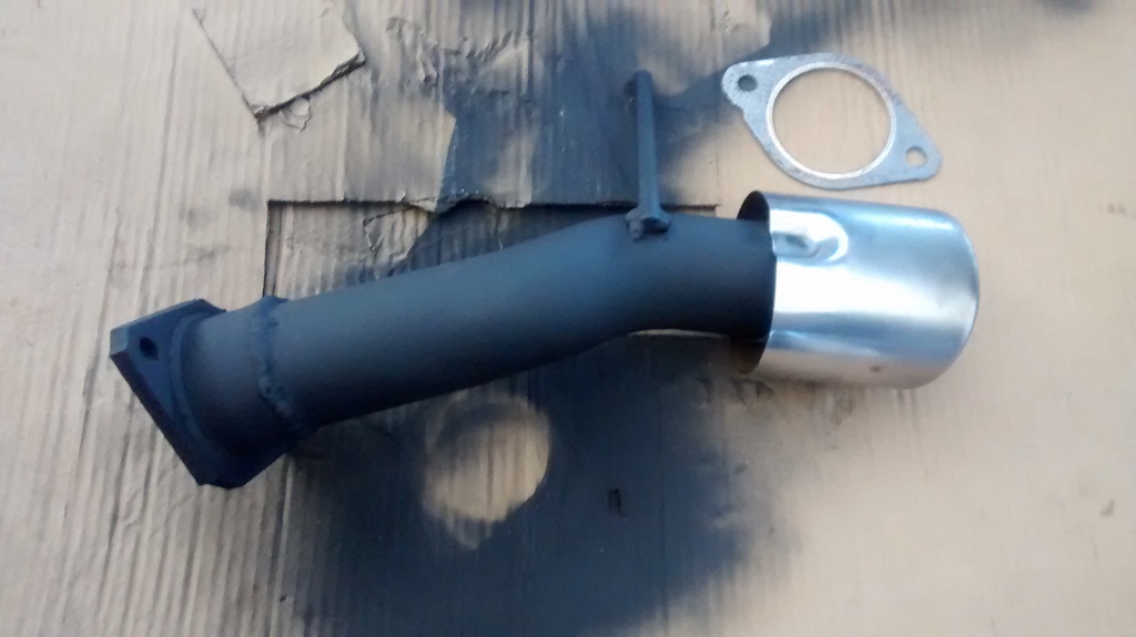

Step 5
Weld the two pieces of pipe together as well as the hanger rod, paint and reattach the muffler tip
Name:  2016-08-01 16.49.07 (1024x575).jpg
Name:  2016-08-01 16.49.51 (1024x575).jpg
Notes
This can be free if you don't mind sacrificing your muffler and you own a welder. I paid for a guy to weld mine up as I currently don't own a welder. Also this is not 100% optimal for exhaust flow as the exit pipe fits inside the flange, creating a small lip which will cause some disruption to the exhaust flow, but I can't believe that there would be much impact that close to the end of the exhaust and with so little restriction overall.
