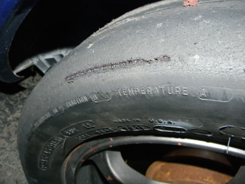

Becarefull of those tires. This happened to a local driver of ours at one of the tours. After 12 runs. Thats right I said 12.
Also coming from Hoosiers and Hankooks he had to run a lot more pressure up front not to roll over. normally 45 psi up front but I think he was pushing 55 with these not to roll over. Mazda 3 hs driver.
