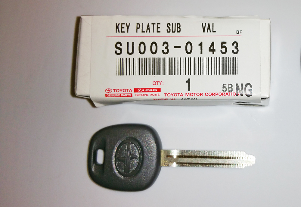

5. Genuine Scion valet key, Toyota PN: SU003-01453. The cheapest option is Camelback Toyota at $63.67, with free shipping for orders over $150. I ordered multiple keys.

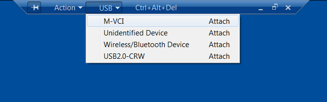

2. Plug the M-VCI cable into your car's OBD2 port and into the USB port on the computer. Attach the M-VCI cable by clicking on USB at the top of the screen and the appropriate device. The biggest problem I've noticed with devices not attaching on new computers running XP mode is the fact that there isn't a driver for an Intel USB 3.0 controller for Windows XP. You can solve this problem temporarily by going into the BIOS, and under USB settings there should be an option to set the XHCI Pre-Boot mode to Disabled. This forces the USB 3.0 controller to run under USB 2.0 mode.

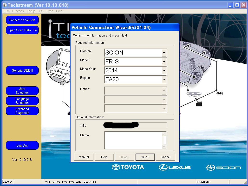

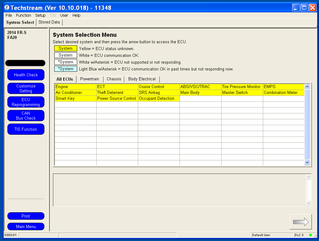

4. Once you start up Techstream, click on Connect to Vehicle. I have version 10, and the menus may slightly differ from other versions. If the connection is successful, you should see the vehicle detected. If the Division says Toyota and other fields are blank, try closing Techstream, cycling the key, and restarting Techstream. Click Next to proceed.

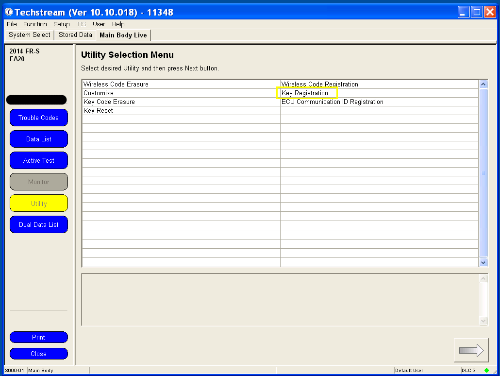

5. Under the System Select tab, double click on Main Body.
6. Under the Main Body tab, click on Utility.

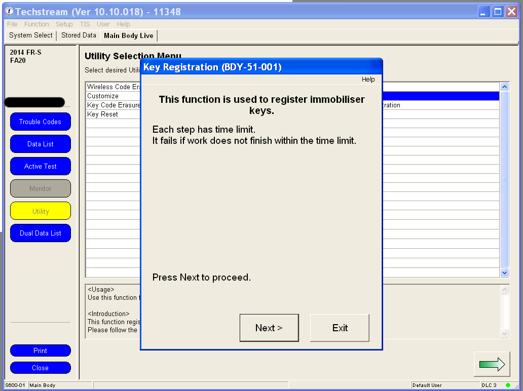

7. If you are afraid that someone who finds your lost keys can open your car, then you may want to use the Key Code Erasure utility first. I have never used this utility, but if you search on youtube there are plenty of tutorials. Under the Utility screen, double click on Key Registration to continue.

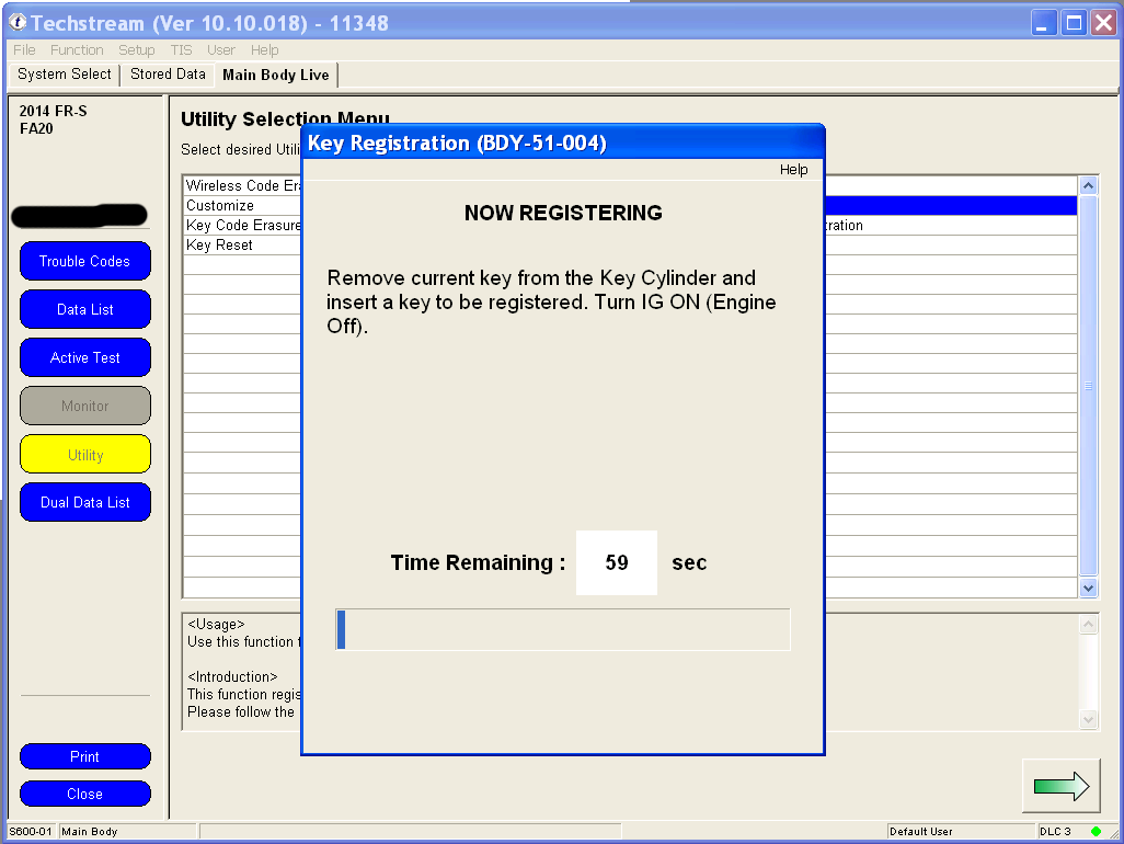

8. Have your generic non-chip cut key and your new uncut immobilizer key ready. Under key registration, click on Next to proceed.

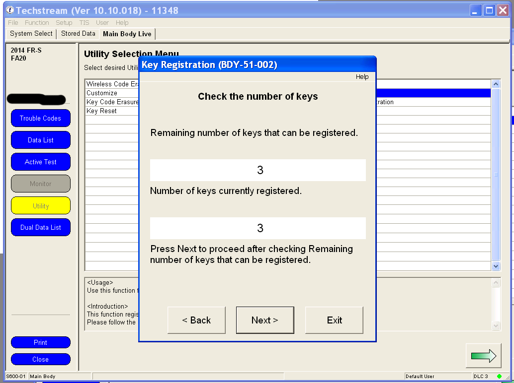

9. If this is your first time programming additional keys, you should see 3 keys registered and room for 3 more keys. Click next to continue. Your programmed key should still be in the ignition cylinder switched to ON. You will have 60 seconds to complete each step.

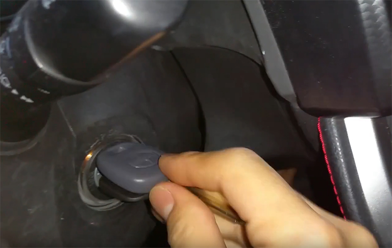

10. Now you have 60 seconds to remove your programmed key from the ignition switch, and insert the new key. Insert the cut non-chip key into the ignition switch while holding the immobilizer key against it, so that the ECU will think that you are inserting a cut immobilizer key. Turn the keys to ON but don't start the engine.

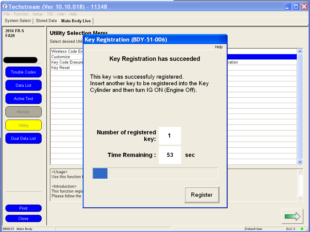

11. The programming should take 1-2 seconds. If successful, you should see the following message immediately. I forgot to take a screenshot, but from my memory I recreated the message that you should see. If you have further keys to program, take both keys out of the cylinder, and insert the generic non-chip cut key along with a new non-programmed immobilizer key held next to it back into the ignition cylinder. Turn to Ignition on but don't start the car. Programming should take 1-2 seconds. Again, you have 60 seconds to complete this process. If you have no further keys to program, just let the timer expire.

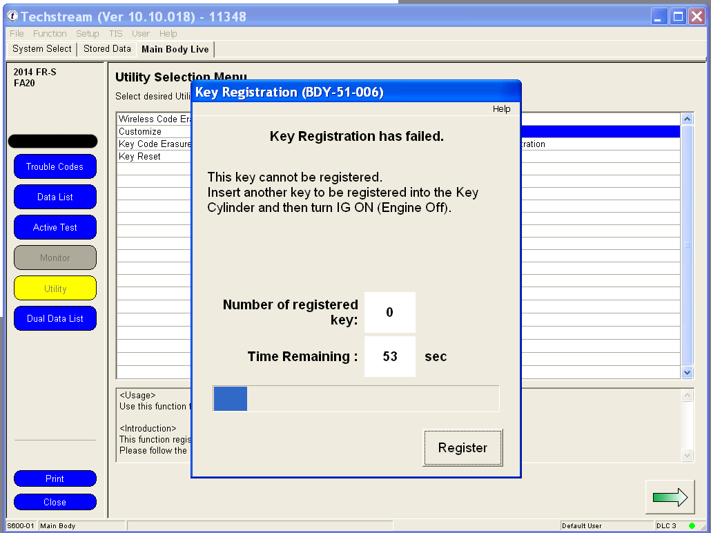

If you accidentally insert a programmed key back in, you should see the following error message, with another 60 seconds to insert the correct key.

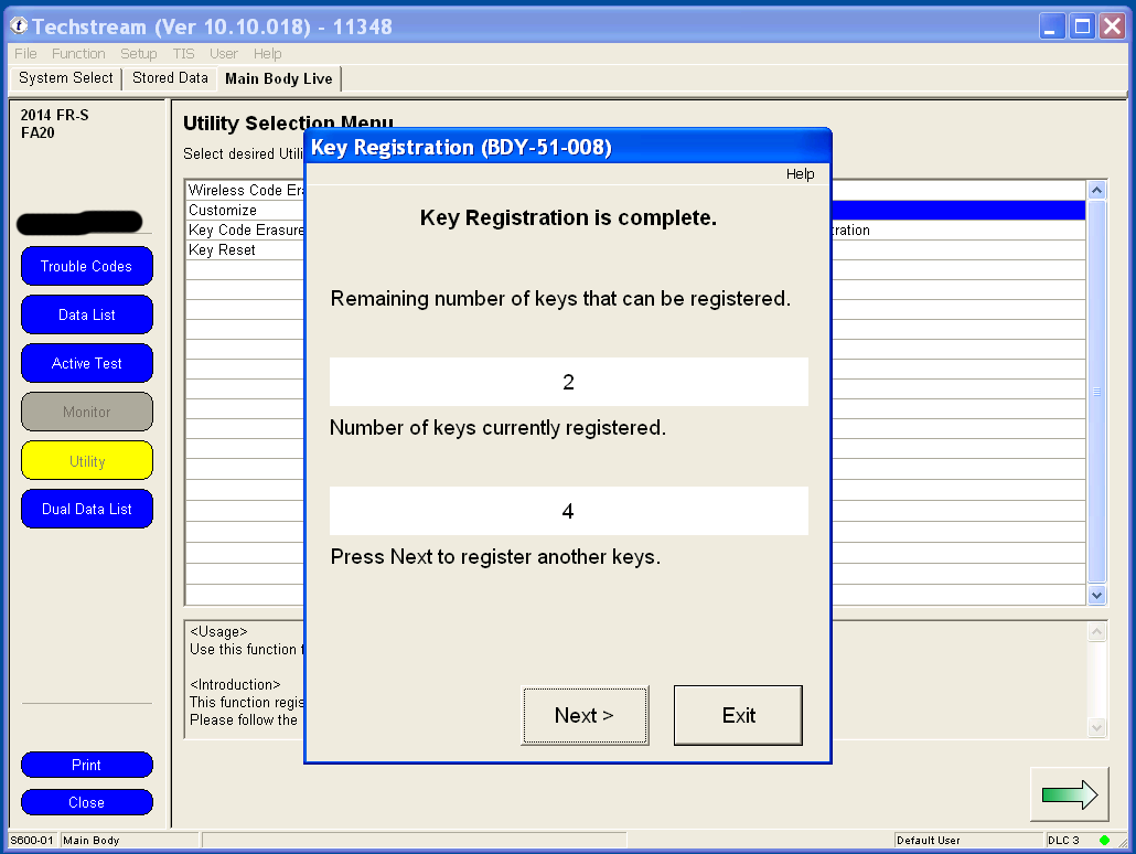

12. Once complete, you should see the following message. I only programmed one key in additional to the 3 that came with the car, so I have 2 spaces left.

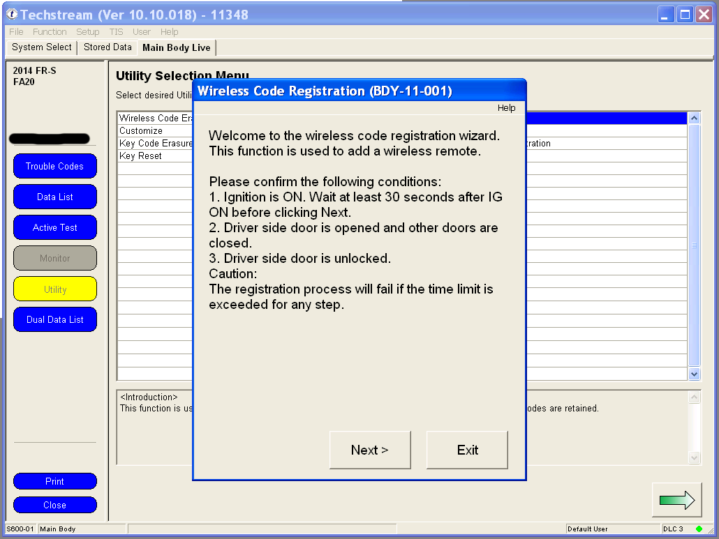

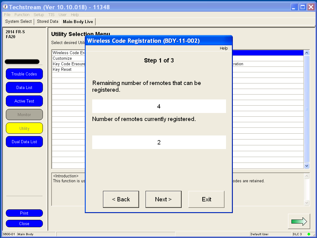

1. Under the Utility menu, select Wireless Code Registration.
2. If your key is not already in the Ignition, switch to Ignition ON but don't start the car. Wait at least 30 seconds before clicking Next. Make sure the driver's door is the only one that's open and that it's unlocked.
3. The body computer can remember 6 remotes. If this is the first time that you are adding an additional remote, you should have space for 4 more, like me. Click Next to continue.
4. You have 30 seconds to complete each step after clicking Next to continue.

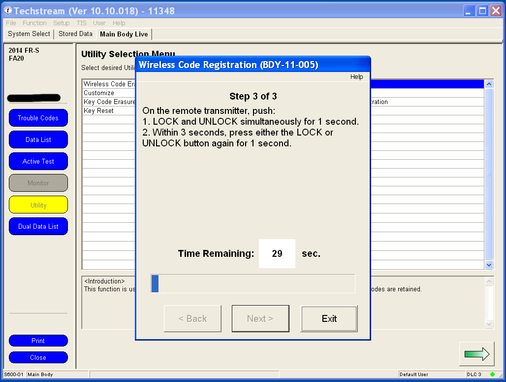

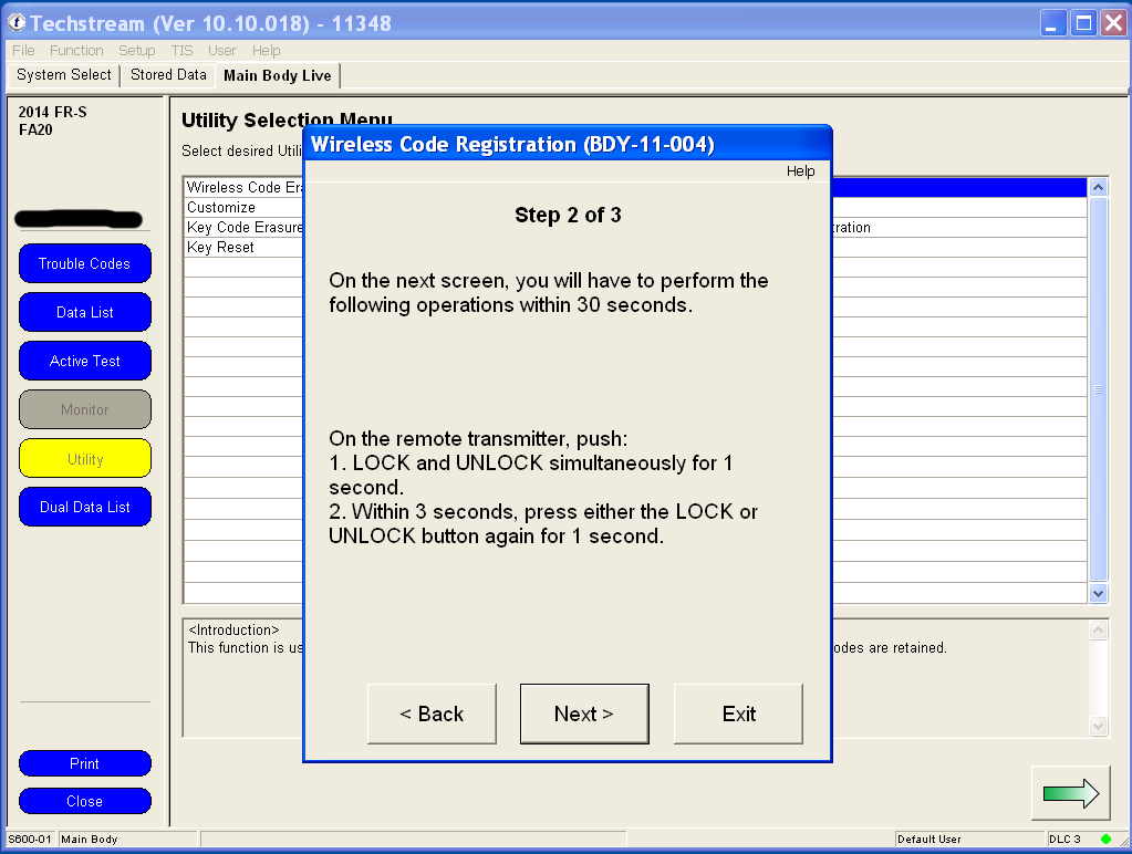

5. Using a new unprogrammed remote, hold both the LOCK and UNLOCK buttons for at least one second. Then press either the LOCK or UNLOCK button once for one second.

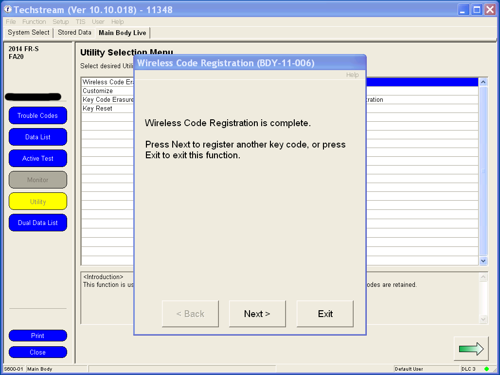

6. The body computer will communicate to Techstream that a remote has successfully been programmed. Press Next to program another remote, or click Exit to finish.

I love this thread hopefully it never gets deleted or images gone. So "key code registration" is to register a new key. "Key code erasure" is to remove all other keys, but one. "Wireless code registration" is to program the buttons of a key.
I'm assuming "Wireless code erasure" is to remove the buttons from all other keys.
But what's "Key reset"...?
