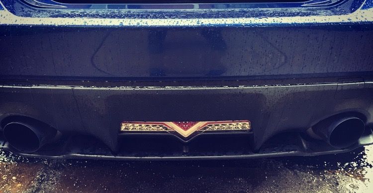

At this point, I saw a fellow FRS owner with an eBay rear diffuser, and decided to have one for myself. I want to say it was like $80, and the fitment is spot on. The instructions are garbage, but anyone with any experience with trim pieces could figure it out with no issues. I didn't drill any holes for mine, and I've had zero issues with sag or it being too loose. I also added OEM Toyota mudflaps to help with the debris coming from the wider tires. Good mod, but I'll be switching to the RallyArmor mudflaps soon. (See exhaust picture below for these mods installed on the car.)

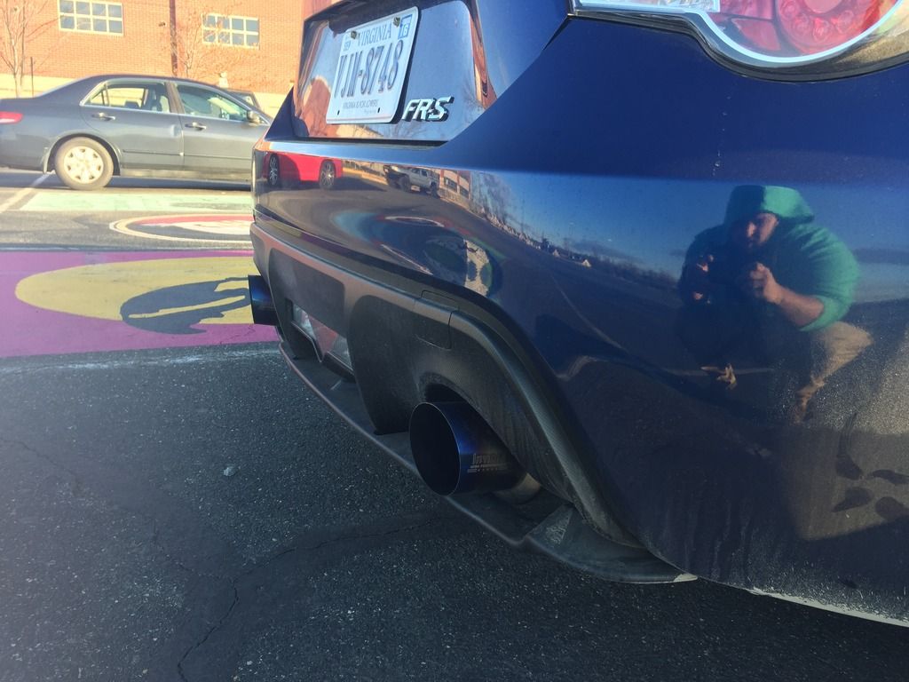

I was really annoyed with how much the stock catback muffled the UELs, and like everyone else with this car, I was after the boxer rumble. That came courtesy of an Invidia N1 resonated catback.
(FAQ: Yes, it's loud. Yes, it drones. No, I haven't received any tickets.)
I was VERY happy with the exhaust, and the butt dyno showed a little more torque, with maybe some high end power gains. Certainly minimal, but definitely felt a little better.

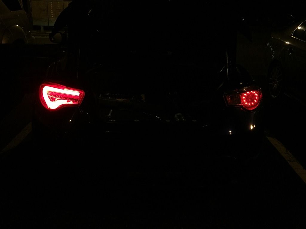

Next, I picked up a set of authentic, clear Valenti tails from a local who was selling at a good price. (Please pardon the crappy iPhone pictures)
Halfway through:
Completed:
Install was super easy, maybe 15 minutes. Still one of my favorite mods to this day.

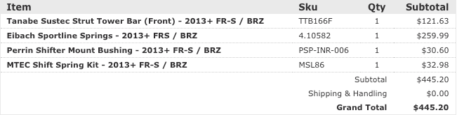

Made an order from @ft86speedfactory:
Very happy with the whole experience. Received the Eibach springs and the bushing 2 days after placing the order, and the MTEC springs a day after that. The strut bar should arrive tomorrow.
I installed the springs first. I chose the Eibach kit for several reasons. I had experience with Eibach in the past, and their customer service has always impressed me. That in and of itself is reason for me to spend a few extra dollars. But I also liked that the Sportline Kit included new bumps tops and dust covers. Modifying the OEM ones was not ideal to me. The install was very straightforward. If you've ever done any suspension work before, this will be a piece of cake. Whole thing took less than two hours, and I did it by myself. I did not use the new dust covers, as my car is still relatively new, and I liked the way the OEM covers fit, as opposed to the Eibach covers. Ride comfort is a 7/10. Not as stiff as stock, but more spring-y. I definitely avoided bumps with the stock suspension, but now it's more of necessity. I didn't take measurements, but if I had to guess, I would say that they lowered the car the advertised 1.4". If not, it's VERY close. I'll take some pictures as soon it stops raining.
I installed the MTEC springs and the bushing the day after. There are two 10mm nuts on the driver's side of the transmission, and FT86's video isn't entirely clear, so make sure that you don't remove your transmission fluid drain plug instead of the spring housing nut. Also, I would recommend dropping at least the front pipe to remove the 21mm housing on the passenger's side. (This was convenient for me, as I was installing a new front pipe as well..more on that below) It's a tight space, and between the driveshaft and the exhaust, there's not a whole lot of room to hand thread the housing back into its location, which is a must!. The MTEC springs are a great upgrade, and I cannot speak highly enough of them.
Next came the Perrin shifter bushing. I'd like to take a second to say kudos to Perrin for great instructions. In my opinion, great instructions make a mod a hundred times better. However, make sure you have extra tampons on hand, as installing it is a BITCH. The fitment is V.E.R.Y. tight. (Perrin says as much in the instructions, but I'm serious...it's tight.). The bushing, coupled with the MTEC springs, in my opinion, are some of the best mods for the money. They drastically changed the feel of the shifting experience, and tightened up the loose shifter. For $60, and an hour of install time, I cannot recommend them enough.

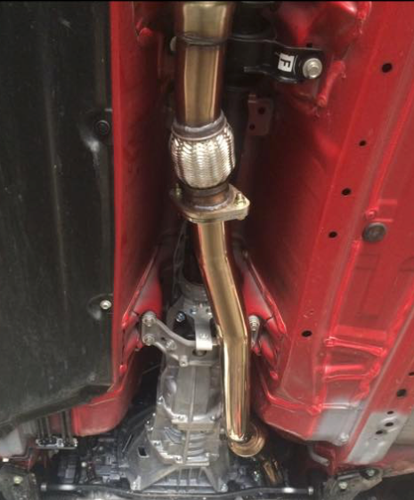

Also got a steal of a deal on an Agency Power overpipe/frontpipe combo from a local. I read a lot of reviews from people who said that AP should be avoided like the plague, but honestly, the fitment was PERFECT, and I had zero leaks or issues. The whole install took literally 5 minutes. It took longer to get my jack and jack stands out and to jack up the car than it did to install the pipe. So I'm pleased as of right now. I'm a little unsure of how I like the sound, as it's starting to become a little too raspy and fart-cannon-y, and less rumble-y, but I've only had it on for ~50 miles, so I'll decide after I put some more miles on it. Supposedly, upgrading the frontpipe is supposed to give an increase in throttle response, but honestly, I don't really feel it. If it's there, it's very minimal.
Picture of it installed on his car, as my car is obviously not red

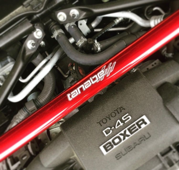

Apparently Virginia has a monsoon season now...anyways....finally installed the Tannabe Sustec Front Strut Tower Bar! Looks pretty good, and I can feel a little more rigidity in the corners. Nowhere near as noticeable as a sway bar, but there felt like less chassis roll to me, could just be placebo. Also installed lower Valenti bumper light. Looks clean, and install couldn't have been easier.
Pictures!
