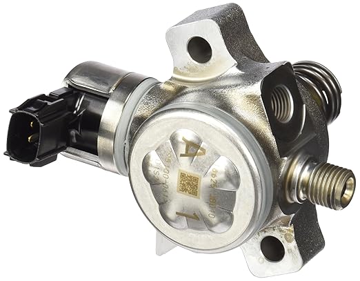

Yeh I'm looking for the Engine mounted High Pressure pump manufacturer.
Yup that part number is SU003-05176
and this is what it looks like:
I'm assuming that sensor on top is mostly made by denso
