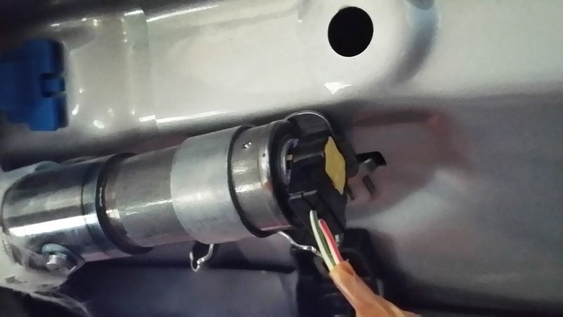

Can anyone tell me how to disconnect the wiring plug on the end of this deployed airbag?

Djust stick a small flathead screwdriver in the slits between the yellow tab and the black plug, and then push the yellow tab upp, after that you can pull it off

Very similar to the attached pics, from my steering wheel install page here:
http://www.scoobymods.com/showthread...76.html?t=4876
Before you unplug or work with anything SRS related, be sure to disconnect the battery wait a few minutes and I like to step on the brake. You want to be sure all the power is out of the system. It's probably not a good idea to pet the cat right before doing too
