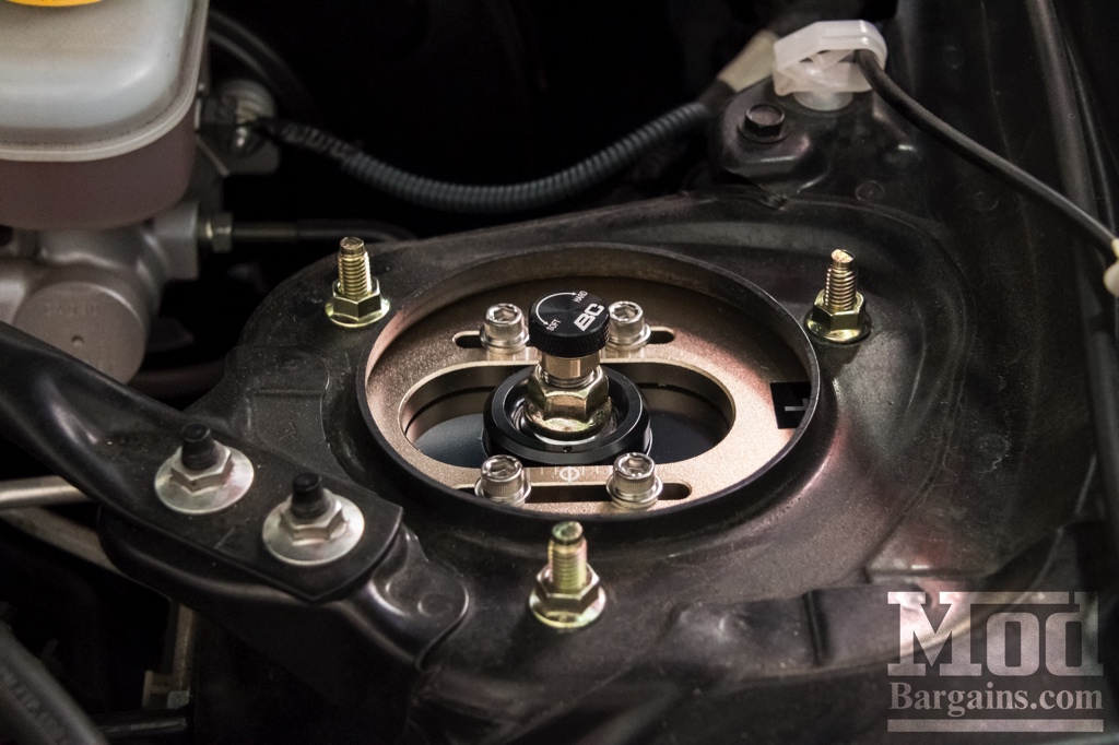

Once installed, coilovers can be somewhat hidden, but the camber plates visible with the hood open really showcase the signature black/gold BC colors and clearly show how easy these are to adjust. The adjustment knobs for these coilovers are on the top, and to change a setting is as quick as opening the hood and counting the "clicks" and you spin the knob clockwise or counter-clockwise.
