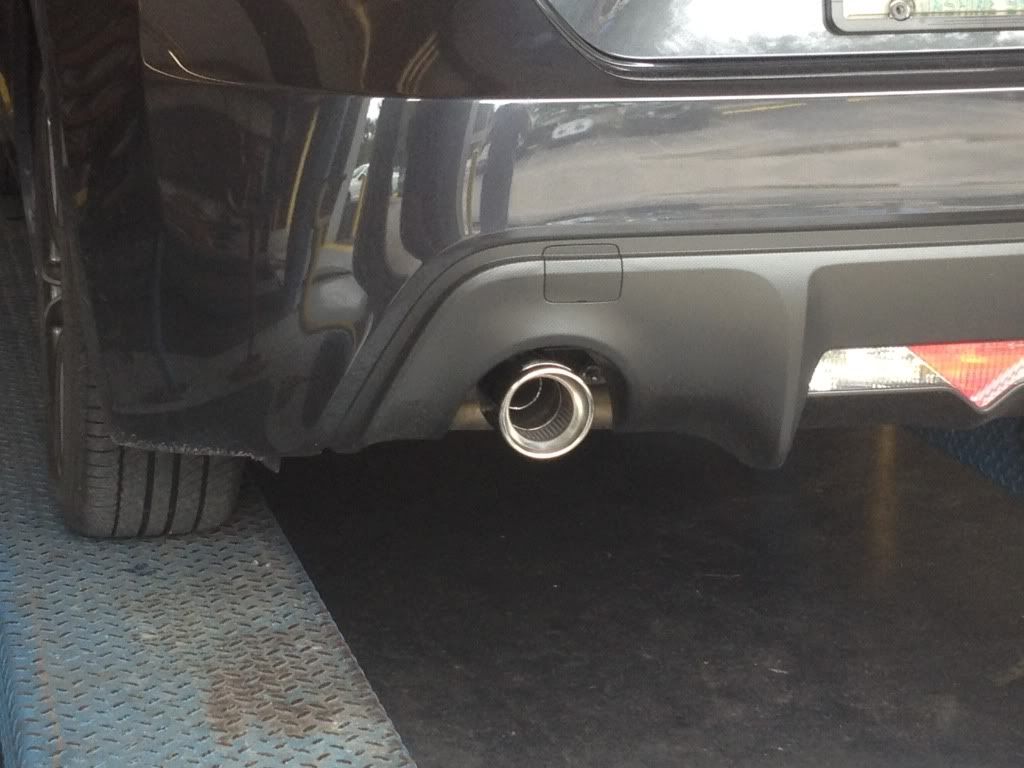

Pictures??
Or explanation of where was the delete...

Here's a pic I took yesterday before they backed it off the rack, the axle back muffler section was just unbolted and we ran a pipe to the side exit with a tip.
Weather is supposed to be nice today, I will try and get a video of the outside up.
