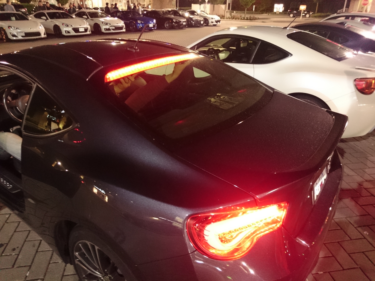

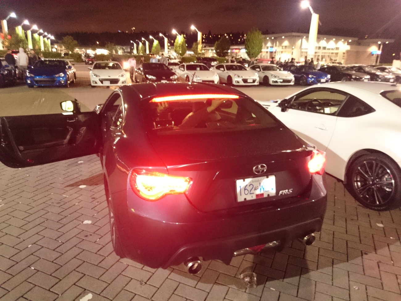

Basically done. Figured I would snap a few pics and show you guys can get some closure and I can stop feeling like there are guys dying to see what it looks like :P hope you guys enjoy it. I will post more pictures when it gets wrapped and fully installed.

@MemphisR it looks awesome!!! what did you use to make it? was it wood and how thick and did you paint it or wrap it in the carpet stuff or did you what did you use to secure it to the headliner?
I'm so exited about this, I can't wait to find a junk yard that has one of these to just pull out for cheap.

Thanks! I used a thin partical board, not sure how thick it was, 1/8"?
As for wrapping, I bought some nice, fake, but nice faux Alcantara. I plan on wrapping more, so thus my use of it on the brake light. I also used that to wrap my rear deck and cover the holes of the old brake light.
I mounted/centered it using the three clips at the back of the headliner and some double sided tape to fix it to the rear window.
