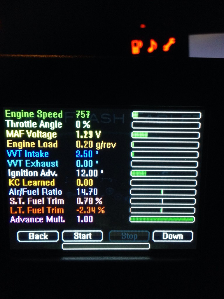

Just got mine! Everything is looking ok!! Name:  ImageUploadedByTapatalk1393033994.068569.jpg

Just got mine! Everything is looking ok!! Attachment 67894
Stage 1?
