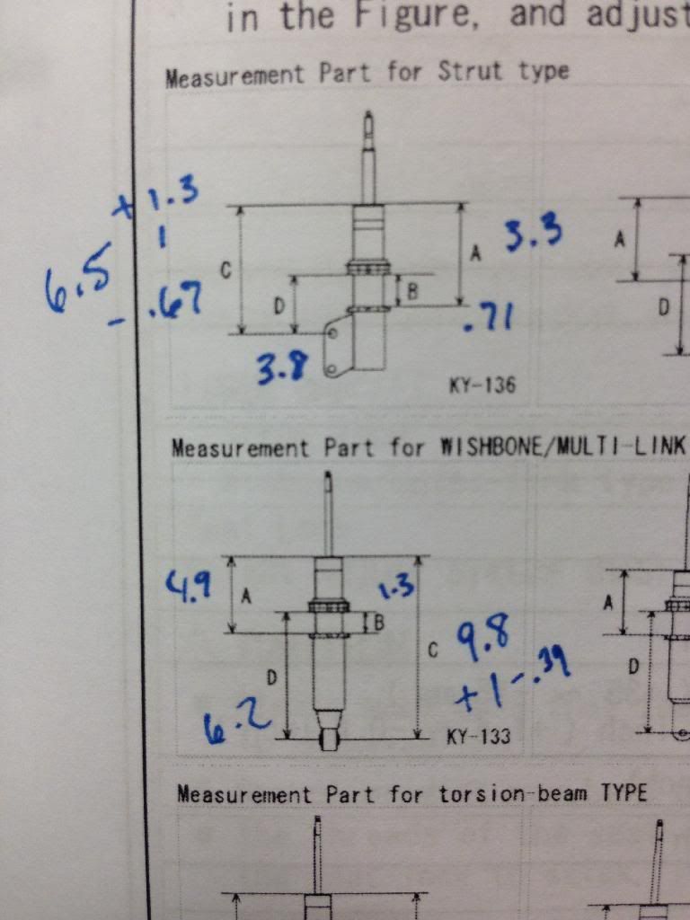

@CSG Mike - I installed a set of Tein Street Flex coilovers and set them up to the recommended specs in the manual for the frs/BRZ. I measured as close as I could get and only the front passenger needs a tiny adjustment.
It seems great so far, especially for the street.
The ride is quite smooth, yet refined and feels more planted.
However I'd like to hear your recommendations for a track setup.
I'm hoping to get about -2.0 front camber and -1.5 to -2.0 rear camber.
As far as spring preload and ride height I'm clueless... And that's why I used Tein's recommendations.

Dear suspension gurus,
Would a smaller diameter tire increase suspension travel?
i am thinking going extreme like 225/45/15 tire on 15x8 wheels.
Currently, it feels like i hit the rear bump stop exiting a corner with full throttle when the tire hooks up.
current setting: Tein H-tech, Koni yellow, whiteline subframe bushing.

It won't increase suspension travel at all. You'll have more clearance in the fender because that tire is 1.5 inches shorter than the OEM tire. You'll also decrease ground clearance by .75 inches and mess up the speedometer. Will a 15 inch wheel even clear the brakes?

No, it won't increase suspension travel. It is "free" lowering, meaning it doesn't alter suspension geometry or reduce suspension geometry (though there are other drawbacks).
You probably are on the rear bumpstops.
- Andy

A taller spring or slightly trim the rear bumpstops. I prefer a spring that comes with replacement bumpstops properly designed.

RCE Tarmac springs.
