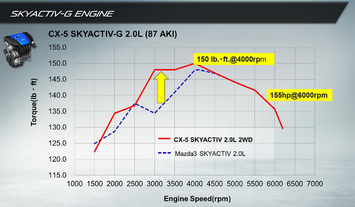

Originally Posted by Sleeperz View Post
Mazda Sky engine 13:1 runs 87 octane.
He calls the 14:1 CR "groundbreaking," though it's a lesser 13:1 in U.S. engines to accommodate our 87-octane regular gas. A "breakthrough" combination of technologies – including direct multi-hole injection, dual VVT, new-design pistons, a unique 4-2-1 exhaust system, shorter combustion duration and delayed ignition during start-up – prevents knock.
What is groundbreaking is how the engine has a typical output with peak torque at 4k RPMs and peak power at a modest 6k RPMs. Most engines that use that high of compression either require high octane and/or extremely high cam profiles. The Prius engines use 13:1 static compression ratio but they make far less than 100BHP per liter. The drawback is that the early '12-'13 MZ3 Skyactiv without the 4-2-1 header does take a hit below 4k RPMs. The CX-5 has the Skyactiv headers while the '12-'13 MZ3 uses traditional headers.
Name:  Mazda Skyactiv_G.jpg
Too much compression can actually hurt power and torque as pre-ignition becomes an issue. Economy engines will typically run pig rich at high RPM/load anyway, to protect the engine. But it's not uncommon for a regular tuned engine to run better on midgrade or even Premium. What with VVT and VCT being commonplace.
I remember reading about that. I assume that the 2014 has the proper Skyactiv headers, correct? I think it had something to do with how the headers wouldn't fit in the engine bay of the previous model, so hopefully Mazda fixed it, though the hp and torque figures are about the same as before, so I'm not sure.
Yup, and the CX-5 had enough room for the new headers from the get go. Mazda3 had to wait two years for the new chassis. The peak numbers aren't what is important for a DD, it's the low RPM operation that can make or break an otherwise good car. As it affects not just acceleration but throttle response.
