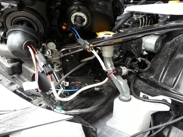

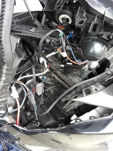

@civicdrivr Can someone take a look at my wiring and let me know if I've got it right? I'm pretty sure it's incorrect and need someone to correct me. Let me know.
Passenger's side:
Driver's side:
Edit: I just saw the post close to the top of this page by @raul referring to the wiring. I will give that a shot.
Thanks,
Ron

Drivers use high beam y splinters ut wring and plugged in to your low beam and missing the hid solenoid

Got everything figured out and so far, I'm quite impressed with the quality of light these projectors give.
A special thanks to @civicdrivr for this very helpful DIY and all those that contributed along the way.
Note: I also was able to remove the bumper without breaking the tab for the side markers. Getting the bumper re-installed at the corners was challenging, but doable.

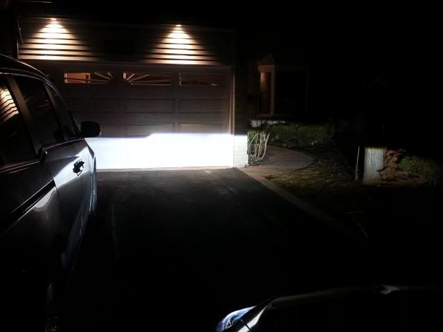

I think I need to align the projectors, but here is the output:

Excellent results, aiming them makes them even better. Besides up and down don't forget left and right adjuster as well. I did the first time.
