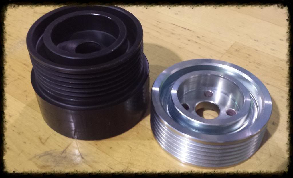

They are coming...

Originally Posted by Andy@FA20Club View Post
They are coming...
Right on time! I'll take the one that produces 100psi. Just now putting the finishing touches on the wings in the garage.
