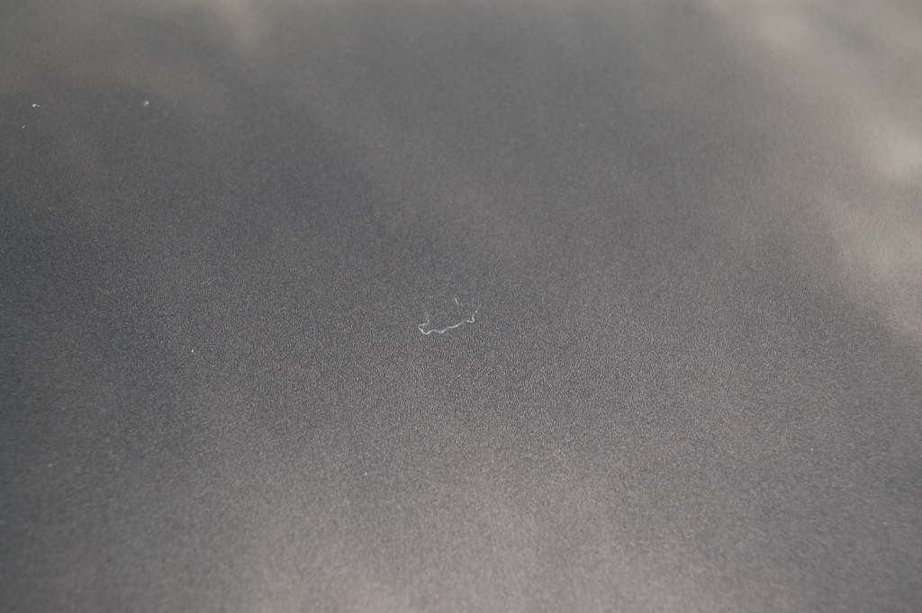

Question about paint protection film/clear bra?:
I just bought a '13 FR-S...9K miles, asphalt. During the test drive (the salesman let me take it by myself) I parked it and inspected it very carefully. I noticed there were maybe 10 places on the hood with small irregular blemishes in the "paint"...looked like acid rain, or maybe salt damage. I pointed it out to the salesguy (you had to look pretty close to see them). He said he would have their detail shop try to correct it, and call me. I'm a fairly car-savvy guy, and I really thought they would just buff out. (I didn't know about paint film/clear bras)
When he called and I went back, the blemishes were much smoother, and less noticeable, but still there. He said the detail guy had ordered some "special touchup" from Toyota, and that would complete the "repair". He gave me a "we-owe" to finish the work. I negotiated a $1000 price reduction, and bought the car.
I have since learned that the car has dealer/port installed paint film, and suspect that the blemishes are actually "bubbles" that were left when the film was installed.
Comments, thoughts, recommendations???

If your car for sure has clear bra on it, there will be a line running across your hood because I doubt they port installed a full hood kit, then yes there's a high chance they could be bubbles left behind by the installer.
They could also be pieces of dust, or sand, debris as I call it. Could you post me some pictures so I can asses the situation better for you.
A bubble will typically stand out pretty obvious and you won't have to look hard to see them. A piece of debris under the film is a little less noticeable in which case you'd have to look hard to see it like your describing.
If the car doesn't have film on it, I wouldn't be surprised if the dealer re painted the hood and what your seeing are imperfections in the paint called burs or fish eyes.
Of your 100% sure it's a bubble, get yourself an insulin needle, poke the bubble with the tapered side of the needle towards the paint, draw the syringe plunger out to suck the air, put slight pressure on the needle that is still in the film and them remove the needle while your still pressing on it lightly.
Post me some pics and I'll tell you exactly what it is. You might have to get creative with lighting and camera angles to capture what you want me to see but please give it a shot!!
I'm here to help

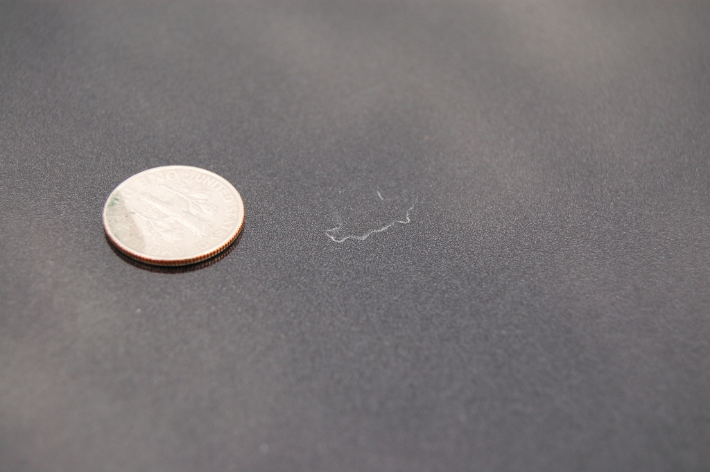

Ghost-
here are my pics. I took them with my Nikon D50 hoping to get the best resolution.
After careful inspection, I really don't see any evidence of the paint film on the hood. There is no line, and I can't see any "edges" anywhere.
The original window sticker says "YPPF3 Paint Protection Film $ 199.00"
I'm here to help

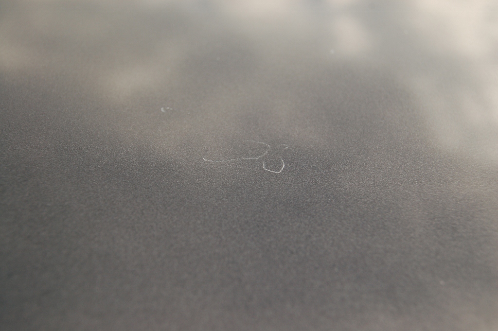

One more for scale: (that's a dime)
UPDATE: YPPF3 Option does NOT include the hood... only door edges, door handle cups, and rear bumper under the deck lid

Gotcha. Glad you figured out where the film is covering. Those are all good a areas to cover for a little protection.
Yeah that almost looks like the clear coats flaking a little bit in that spot or it's a serious hard water spot or like chemical burn.
Take your finger nail and ligntly scratch over it, if you feel a bump or your nail hang up on an edge then the clear is flaked.
If not flaking, rub on it by hand with a rubbing compound then a polish then wax.
Hope that helps man.

That's simple water etching and possible bird bomb etching. The clear coat is slightly degraded but not compromised by any stretch of the imagination. A simple polish will level the clear coat appropriately and make those disappear. Coat it with a sealant or wax of your choosing.
