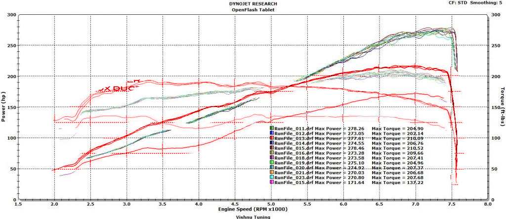

Originally Posted by shiv@vishnu View Post
Put the new Vortech SC off-the-shelf map through some good stress testing today on the dyno:
OFT+OFH+Votech SC (9psi)+Perrin CBE vs Stock
93oct
These aren't glory runs. But a good representation of a relatively conservative tune that should be suitable for general use if hardware requirements are met.
